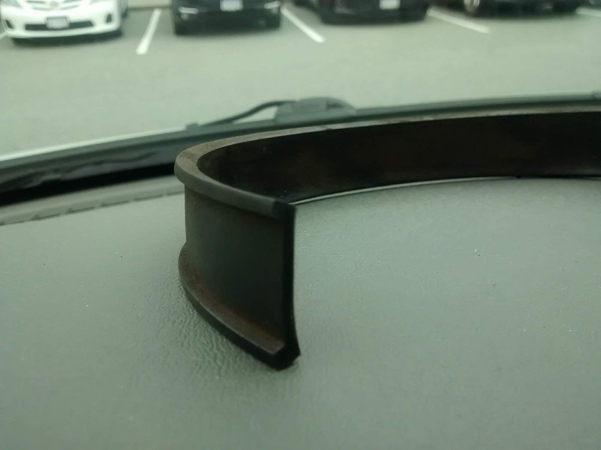

I went to a local spring ship and showed them what I needed. The guy there brought out a piece of this stuff and gave it to me.
Unfortunately it's too narrow. So I decided to go with my crazy inner tube idea.
I took the clips off, and threaded a piece of inner tube over each clip, and put them back on. It's not pretty, but it works. And they shouldn't fall off anytime soon. Rattle gone.
