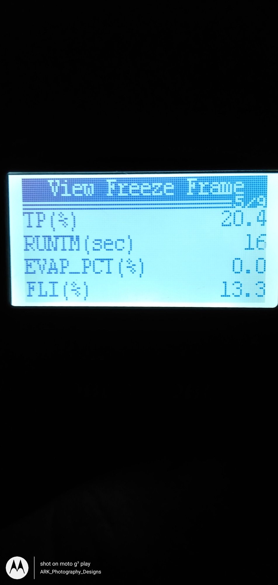

When I check the freeze frame data LMAO 1/3 say -94.9 switch to .08. And 2/4 say .90. This damn van is possessed. Oh yeah, and some A-hole WELDED (not even joking, ded serious) the oil drain plug into the oil pan.

Recent FF Data
