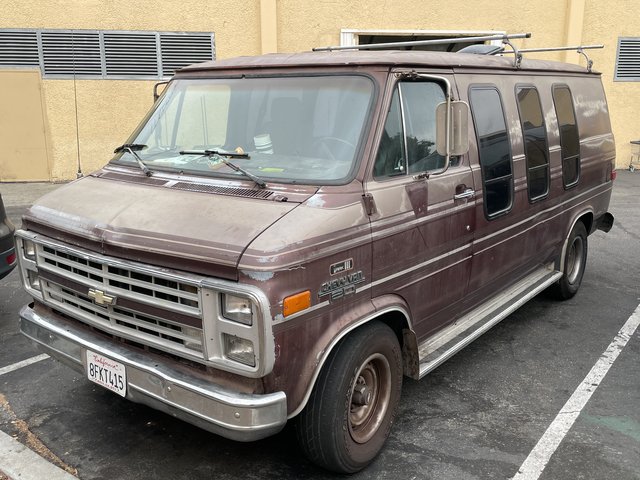

Funny you should mention, I’m looking for a grill for my ‘89 G20. Looks a lot like yours.
Here it is with bone yard bonnet in place.

They list the vehicles that it fits. Perhaps I could find one at a boneyard with grill in place and measure and otherwise examine it. The chrome strip could be repaired on mine I think, it’s not in horrible shape. But the plastic is beat up in places. Pretty hard to make that look clean again.

What they mean by single headlight only is 1 headlight on each side of grille. Looks like you have dual or 2 headlights on each side.
With dual headlights, the parking light is behind and attached to the grille. Single headlight has the parking light below the headlight. With that grille there would be no way to install your parking lights without making some kind of bracket behind the grille.
