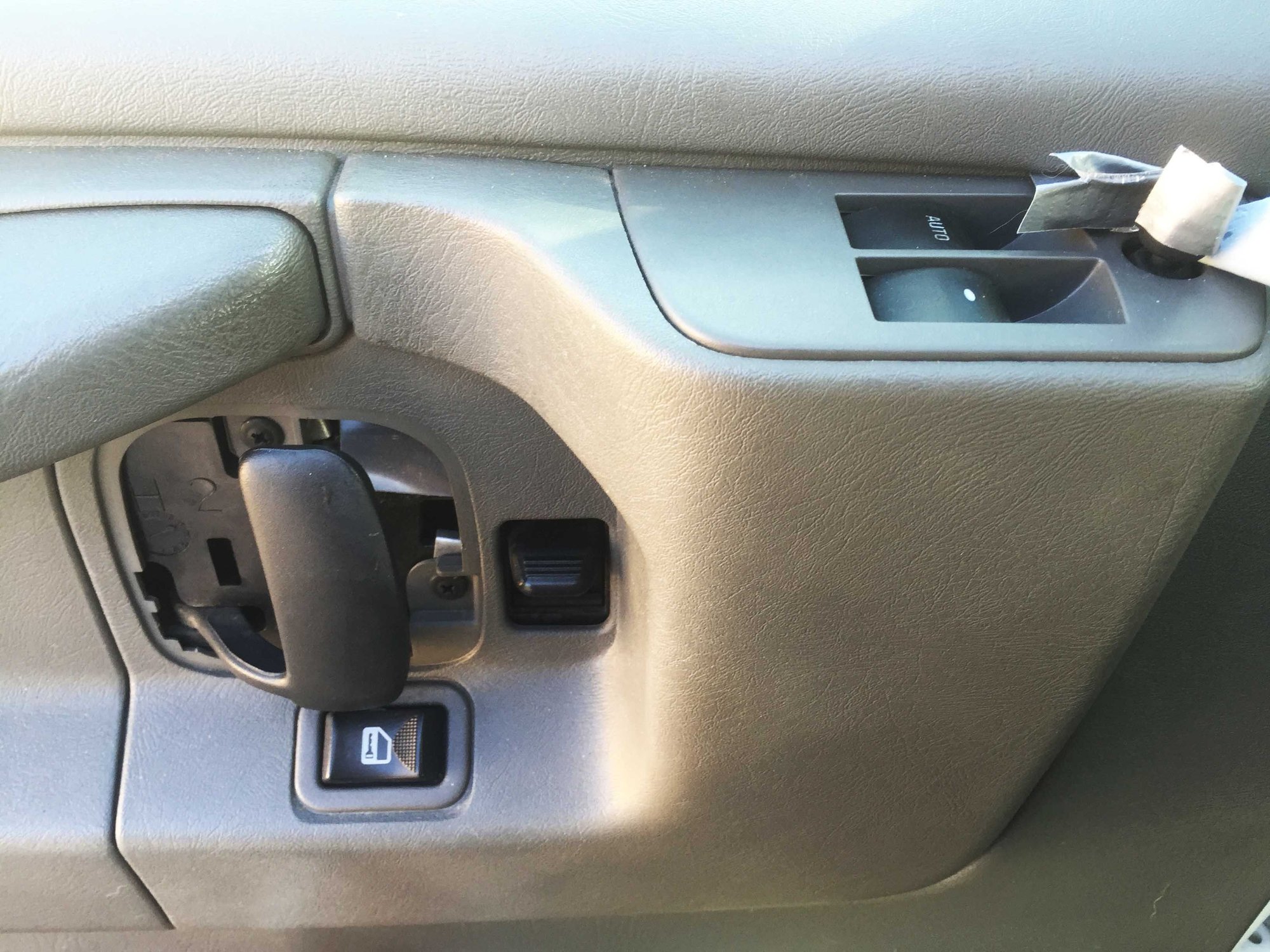

Does anyone have a step by step on accessing the underside of the mirror switch panel on the driver door of a 2010 3500 Express?
Someone else drove my van and I am guessing... thought the mirror control switch was a button and pushed down on it. Either popping off a clip or breaking something plastic that retains it?
I was able to get the switch back up and it still functions. I have it temporarily held up with tape. I am thinking the whole section of door panel behind the handle comes off? Or is the window switch/mirror switch panel able to be popped off?
My luck usually has me breaking off plastic tabs and doing more damage than I had to start with.
Thanks for any help!
2010 3500 Express Driver Door Mirror Switch popped down into the hole of the panel. Shown here pulled back up and held with tape. Switch still functions. Need to know how to properly get to the under side of the window/mirror switch panel.

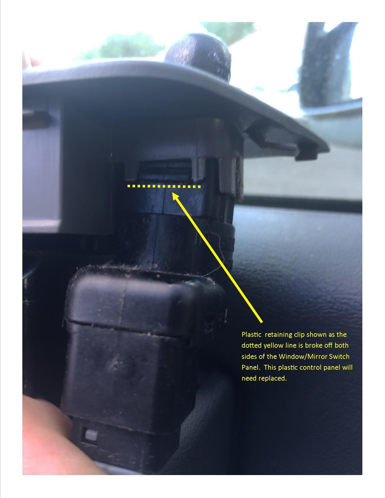

I jumped in and found a way. The Window/Mirror Switch panel can be popped out without removing any of the door panel. There is a fixed clip toward the panel end facing the front of the vehicle...DON'T PRY THE FRONT END
There is a spring clip on the panel end facing the rear of the vehicle. Using a putty knife I was able to get the rear end of the panel part way up, then push in on the metal spring clip with a small flat screwdriver. This released the rear facing end of the panel. I gently pulled that end up to about a 45° angle and rocked and pulled the panel toward the read and the whole thing popped out.

Found the problem. The plastic retaining clips that should secure the Mirror Switch are broke off on both sides. The plastic horizontal control panel that holds the 2 front window switches, and the mirror control switch will need replaced.
Talk about a cheap a-- part. As many of us say....An Engineered point of failure to insure high cost repairs keep flowing into the dealers. Any guesses on cost of part and cost of labor? Probably a diagnostic fee too?

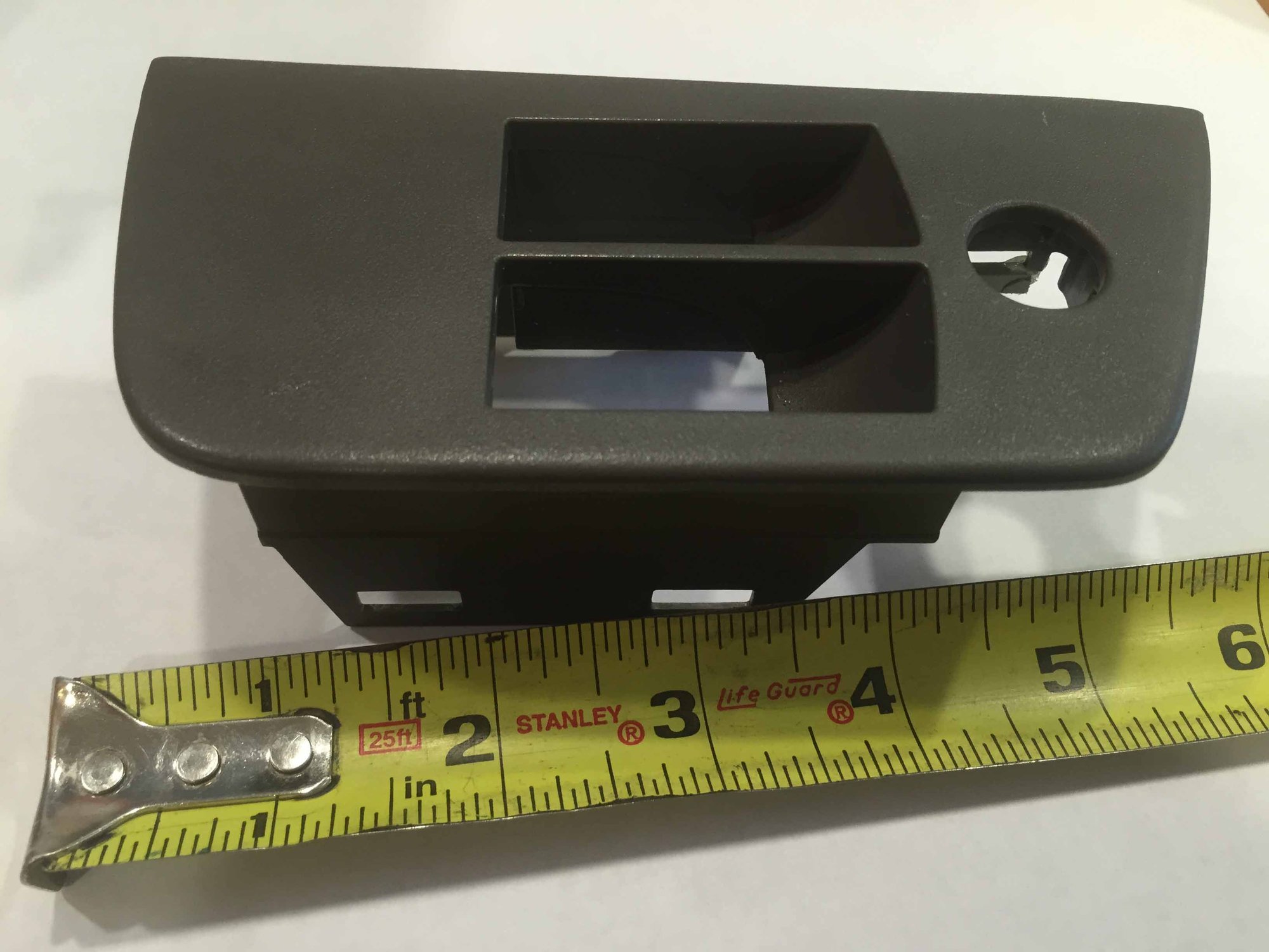

I just called the dealer for a laugh. I can't find just the little panel that broke. Can't even find one at a junkyard. Three dealers quoted me similar info. Part# 20944906 must be ordered. That includes the switches and a larger portion of the door panel. Who are the idiots running GM? They want me to buy from them again?
I think I want to leave it duct taped so I can remember to tell everyone this story.
$335.77 GM Part 2094906
$150.00 Dealer Labor quote
$485.77 With Tax and shop fee's that is over $500
This would take 15 minutes at the most to replace. Can't even get the part. What a rip!
This is the broken part that is needed. Which apparently can not be ordered separately.
