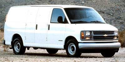

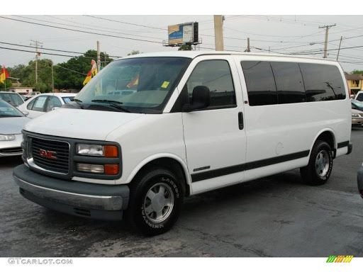

its a 1999 savana and looking online I see that express vans same years have different front ends, are the front bumpers on these 2 vans compatible?

There's two appearance packages there, one with the rectangular lights and a painted bumper, the other with the halogens and chrome bumper (which typically has a chrome grille also). I see no reason why the bumpers wouldn't interchange, as the only actual difference is the type and location of the headlights. 97-02 are the same.
That painted bar on the bottom of the grille is part of the grille, so if you swap that you may need to paint to match.
