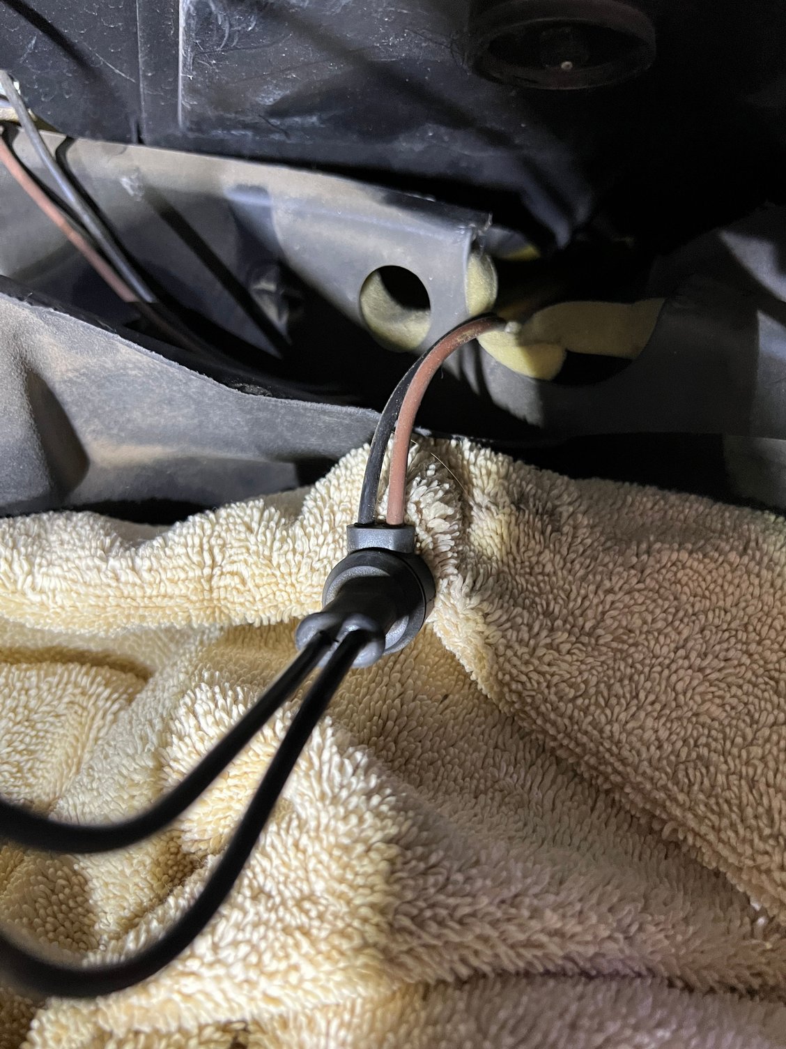

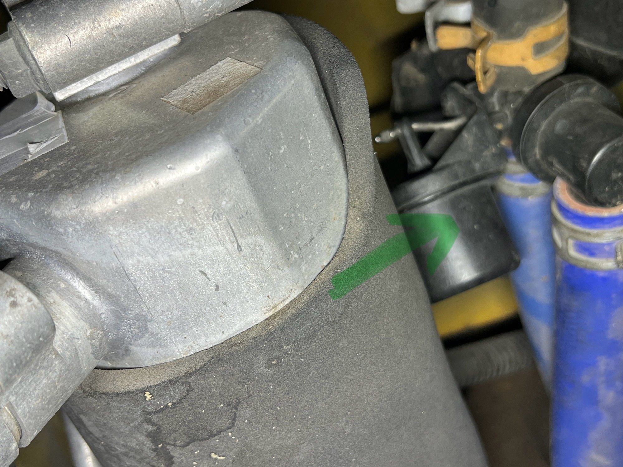

This is on my 2008 express 3500 with a 6.0 motor
Want to replace all the vacuum lines anyway, they all seem brittle
But right now if you get on a the gas for a hill etc the vents stop blowing out the middle and go to defrost

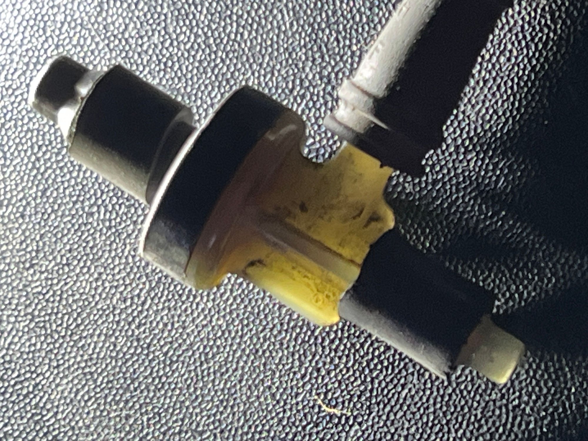

so i got the little vacuum control valve? The $6 one and was going to replace it to start
there are 2 plastic type lines that run through the firewall under the dash, the other side of those 2 in the engine compartment both broke off, they have rubber fitting onto both of them, one goes to the small vacuum thing and the other to that bigger round valve with the green arrow
does anyone have a parts diagram or the name of the 2 wire bundle that goes through the dash there?
thank you

Here are the pics
