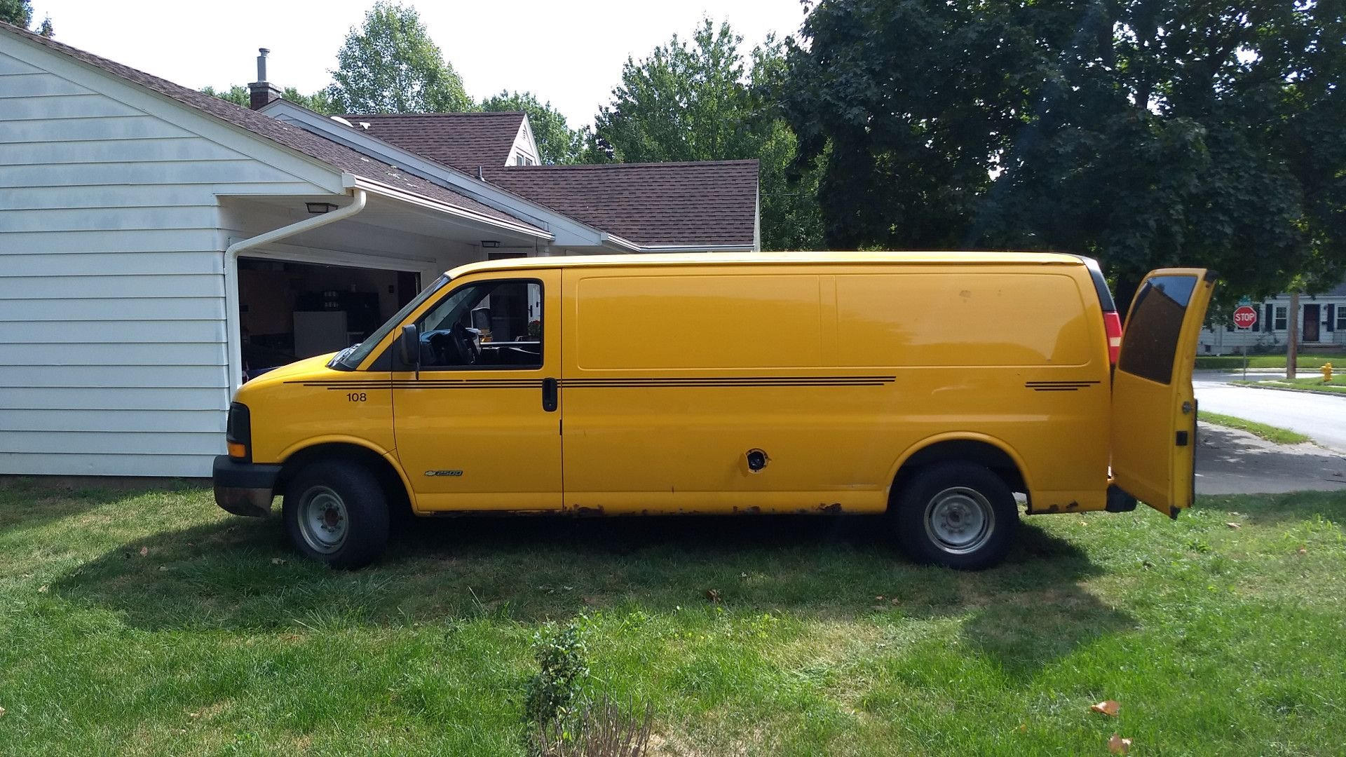

The not so bad side.

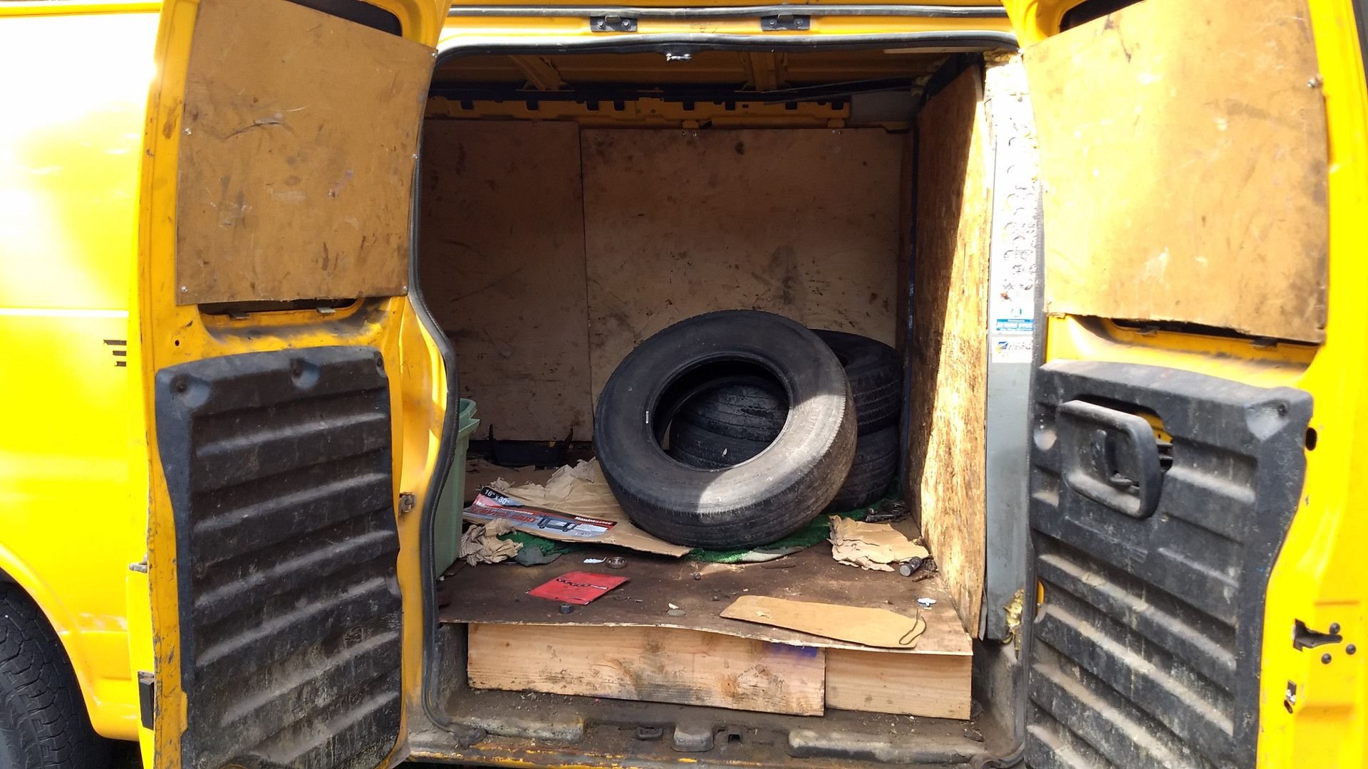

Ah, bonus stuff. And as I learned later, a nice layer of dirt and kitty litter. Pretty sure this was an auto shop junk runner.
