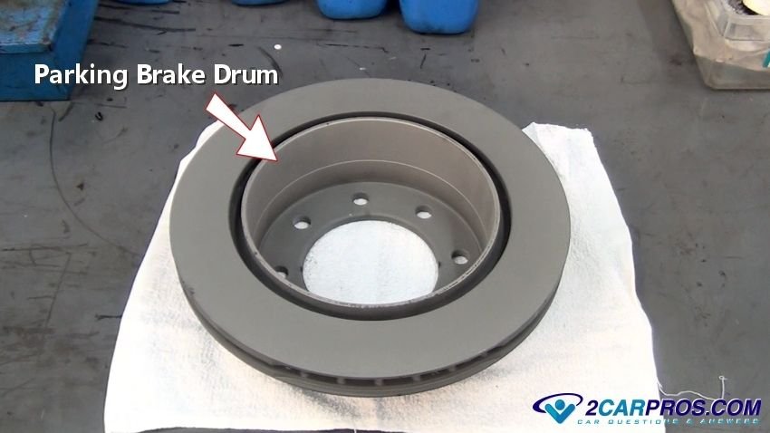

You have disc brakes, but the parking brake is a drum at the center of the disc.
Old Nov 21, 2019 | 8:27 AM
Kael's Avatar
Joined: Sep 2019
Posts: 70
Same as my 2005, you may have disc brakes for actual braking with a drum setup for parking. Odd, I know, having two brake systems with one dedicated to park brake, surprised when I found this on my '87 Corvette. Apologies, not sure of a good way to check you don't have drum parking brake other than remove the rotor.
Example of disc/drum rotor:

I'm the original poster of this thread, now have a new user name. I finally got around to following up on adjusting my parking. Kael was correct. They are adjusted exactly as He stated. I removed the right side rotor to confirm and immediately spotted the adjusting slot. The lining was 50% so I reinstalled the rotor made a slight adjustment , just a slight drag on the drum. But before adjusting I depressed the pedal 2 inches. THIS IS IMPORTANT. By making the adjustment with the pedal depressed, and feeling a slight drag on the drum while turning by hand you probably have it correctly adjusted. When you release the pedal the wheel should spin freely without any drag. It is possible to adjust the brake without removing the tire, but its much much easier with the tire removed. On the right side, spin the adjusting wheel in an UPWARD direction to tighten and on the left side spin the adjusting wheel DOWN to tighten.
