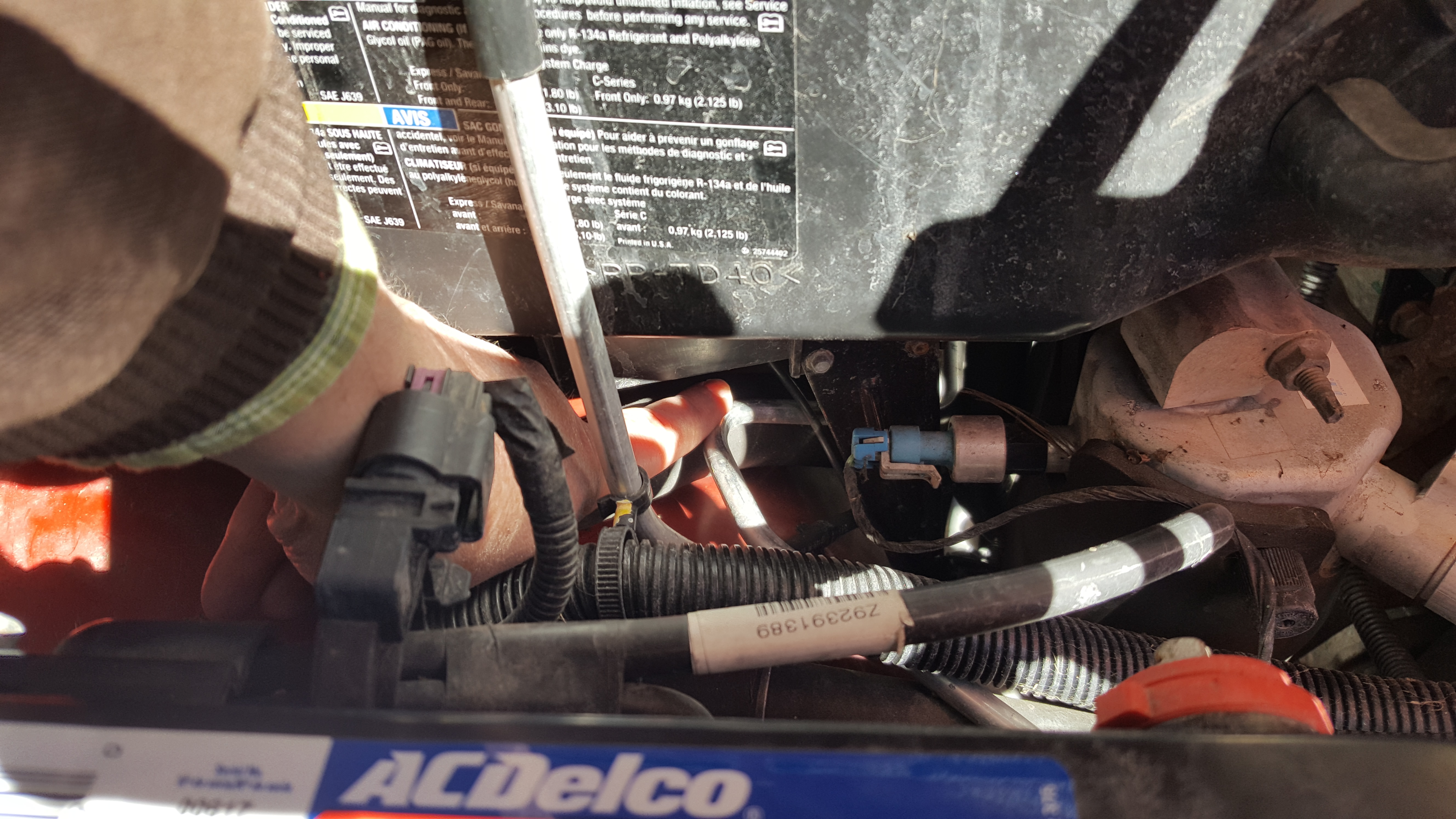

I'm trying to replace the radio antenna base on my 2011 express but how do I access the grommet that goes through the firewall during installation? Its behind HVAC components. The antenna part number is 20830818

Old Mar 3, 2018 | 2:25 PM
Try pushing the grommet out from the inside of the vehicle. You may have to remove the doghouse.

My issue is the install. I cant even see it from under the hood. The grommet has to press into the metal firewall.
You may be on to something with removing the doghouse. Maybe I can get my hand in front of the firewall from inside the van with the cover removed. If I can be a contortionist.

Inside the van under the carpet squeeze the grommet to detach from the firewall metal and push forward. Detach the the antenna cable at the connector. Tie and tape a fish line, I used weed wipper line to the end of the antenna cable and pull it through from outside. I had to pull the grommet through a tight spot shown in the photo. Reverse the procedure to pull the new cable back in. Worked out well for me. Hope this helps.

Thanks for the photo and followup.
