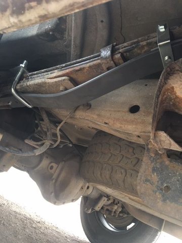

I'm the original poster inquiring about the spring loaded rear shocks for my 2007 2500 express. I now have a new user name. I simply could not locate the spring loaded shocks, but one auto store suggested that the 3500 model would possibly work. I never did follow thru on that. However this morning I went back on the net and did a more thorough search and found these at AutoZone. The price was $33 and change. Took about an hour to install and for my purpose work great. And they are somewhat adjustable. It raised the rear 3 inches and really stiffened it up. And they are removable should you no longer need them. Can be done without removing the tires.

Is this what you got?
https://www.autozone.com/suspension-...rchText=111020
I really like this idea also because of the ease of installation. Questions:
Anybody out there install two per spring? Seems like this would balance the support on the spring.
Have you noticed any noise or creaking from them?
Thank you!
Old Apr 4, 2020 | 9:40 AM
couchmusician's Avatar
Joined: Apr 2020
Posts: 19
Likes: 3
Yes, that's exactly what I installed. No noise of any kind.You might be correct about installing 2 per spring, but only if your load is in the van interior. My load is concentrated on the trailer hitch. I have a small tractor that weighs 2000 lbs and a few implements thats probably 6-700 more pounds. The trailer is 6.5 x 16 double axle. The sagging was mild but that weight created a lot of spongy bounce. The add ons eliminated all of it. I used the middle setting but if thats Your van pictured in Your post I would recommend the rear setting. The settings are explained in the instructions supplied. Thanks for the inquiry.
