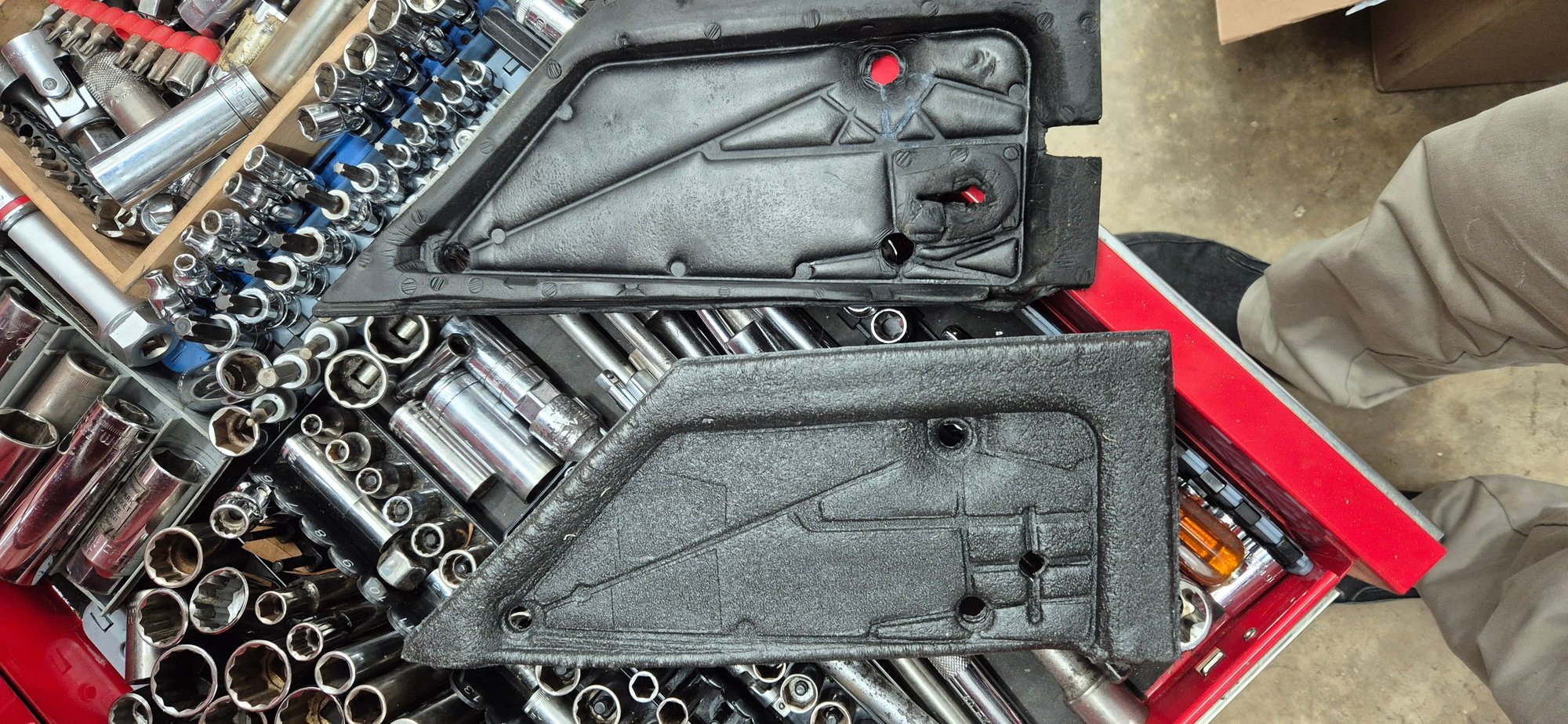

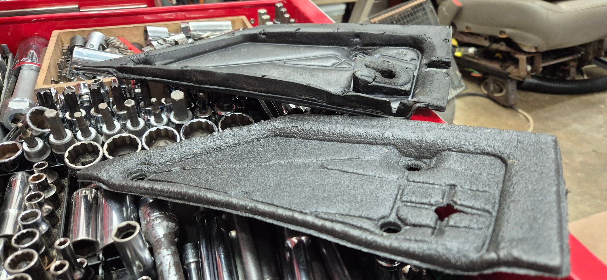

I just installed mine the other day. I couldn't agree more with what everyone else is saying. Shame on GM for such a poor design.
Today was the first day I got to drive it for more than just up the street. Huge improvement. I pulled into a turn lane to cross the street which usually gives me a big blind spot and I just looked at the mirror and can see everything. No more blind spots of cars passing me either.
If I hadn't taken these pictures I wouldn't believe the difference. This is at the end of my driveway with the van in the same place give or take. The red and the blue car hadn't moved.
Install was a little more of a pain with the power mirrors because you have to take the door panel off to get to the plug. I reused the factory foam backing since it was way more substantial than what these came with. Pictures are below.
