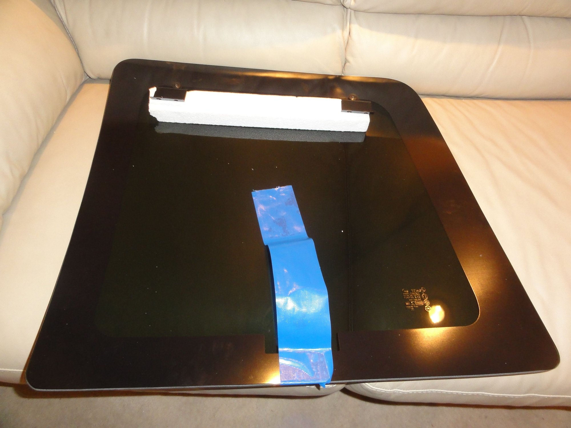

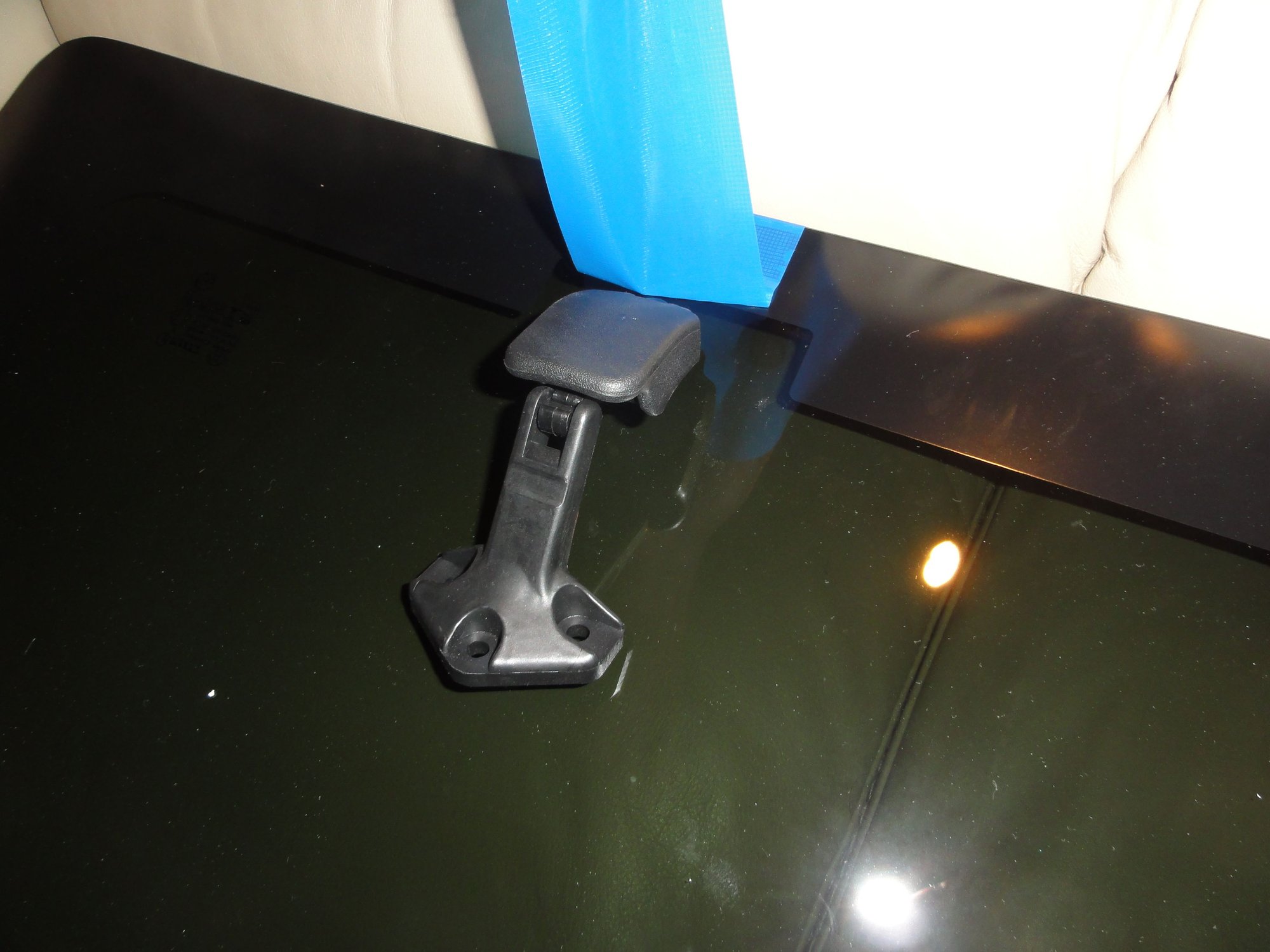

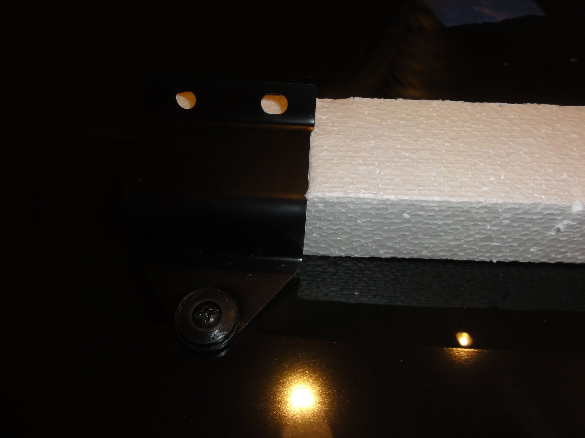

New Glass, Complete with Latch

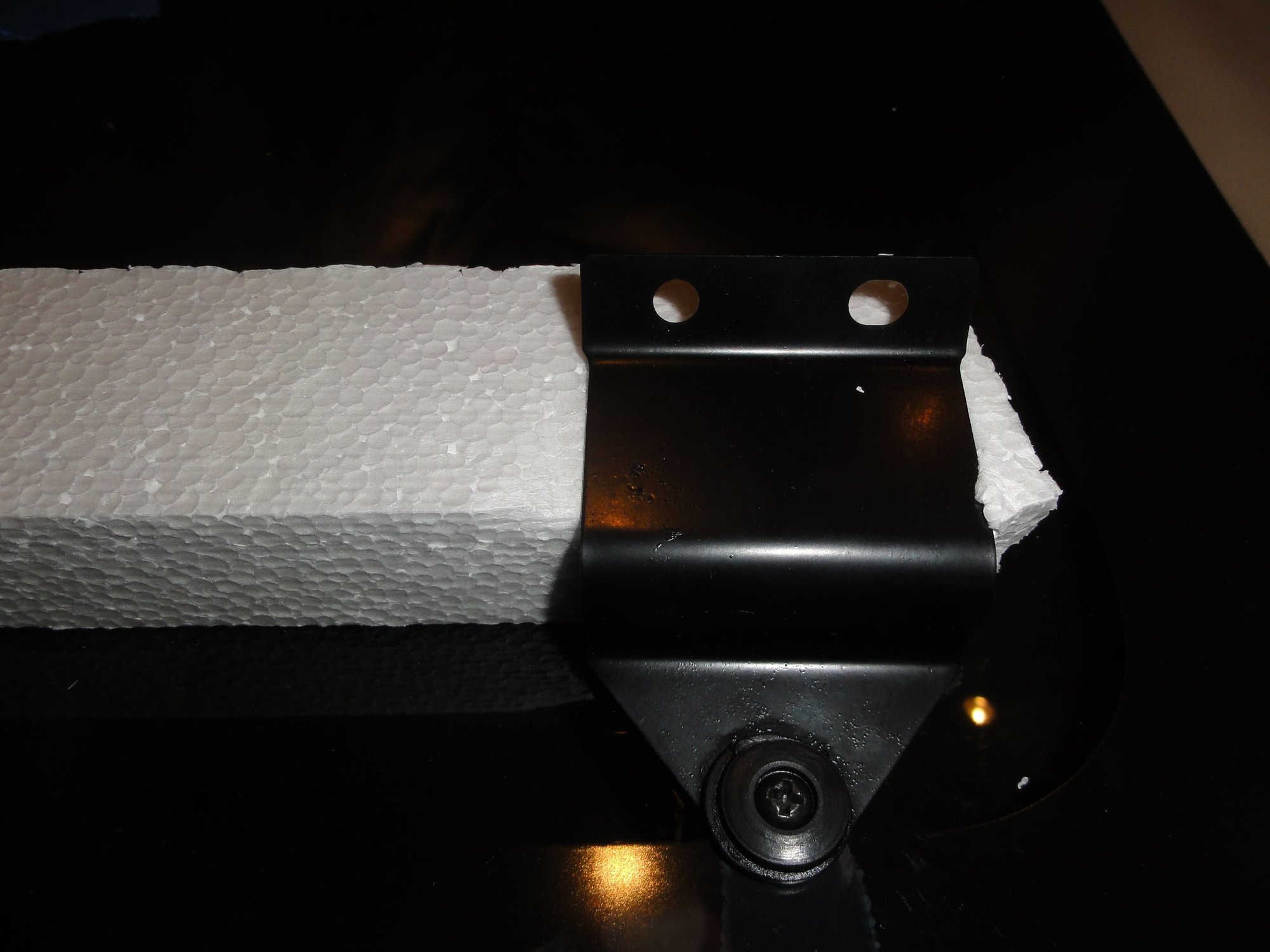

New Glass, Complete with Right-Top Hinge
New Glass, Complete with Left-Top Hinge
New Glass, Complete Assembly

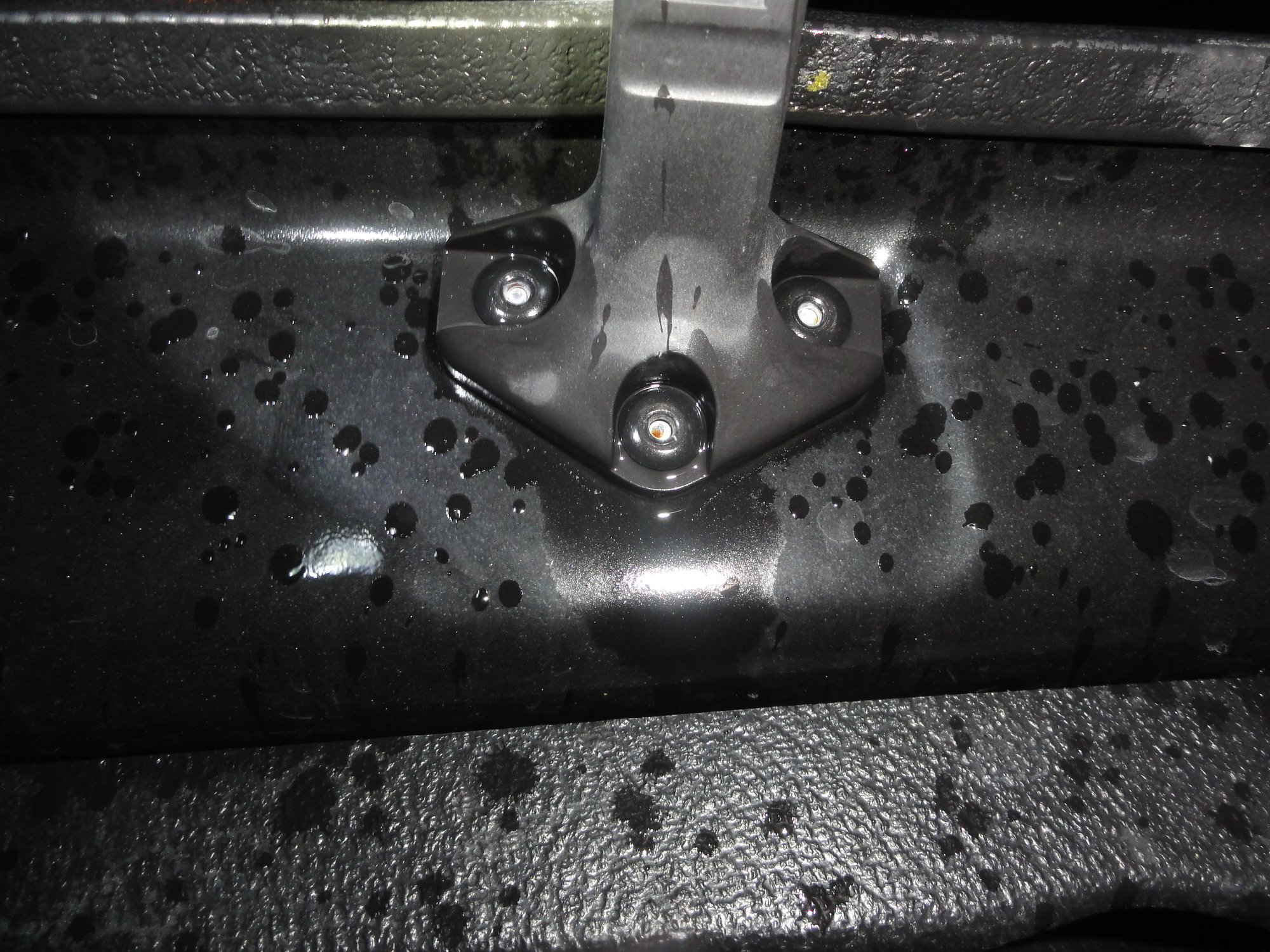

Truck Door, Existing Latch Mount (Riveted)

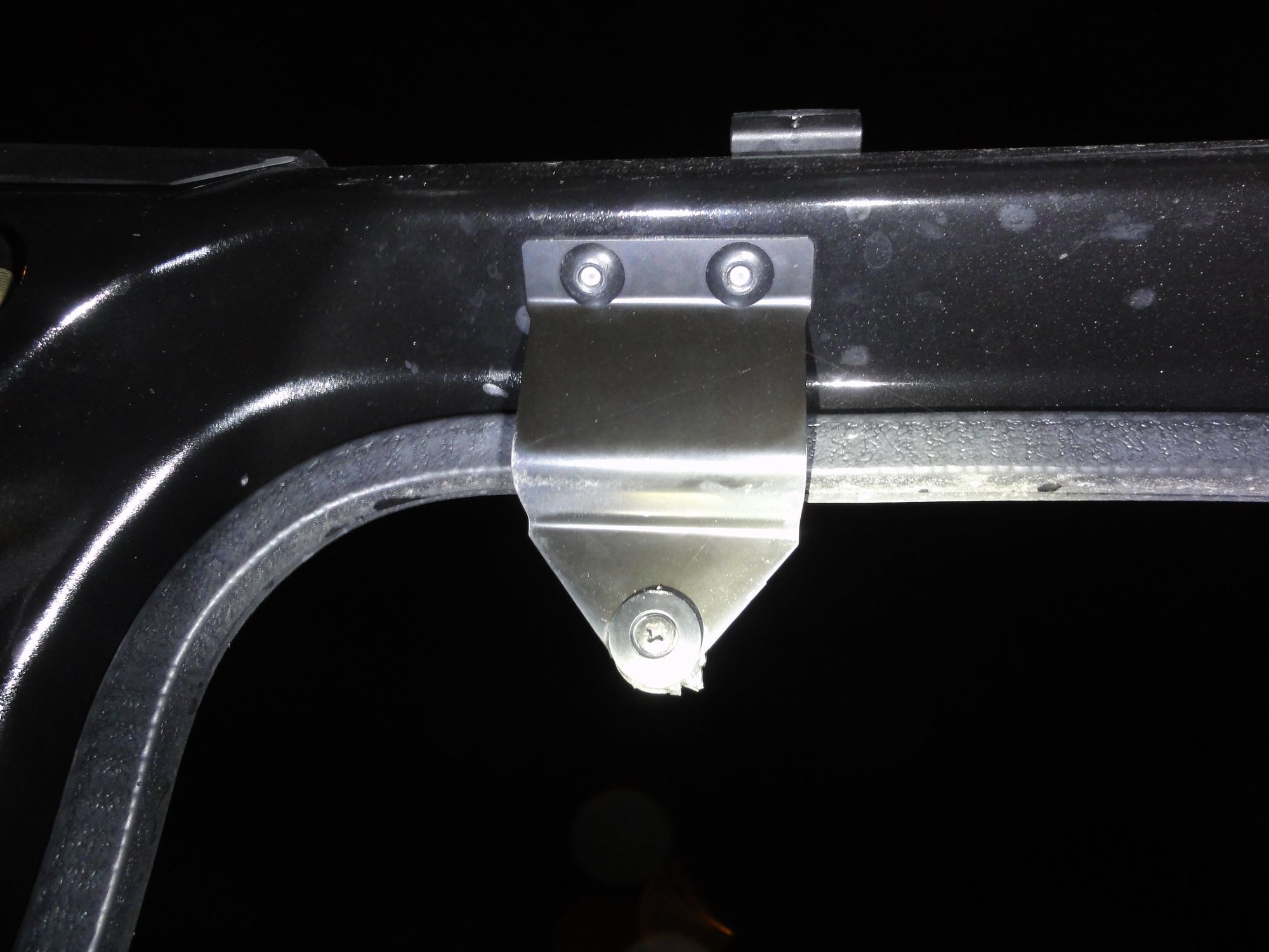

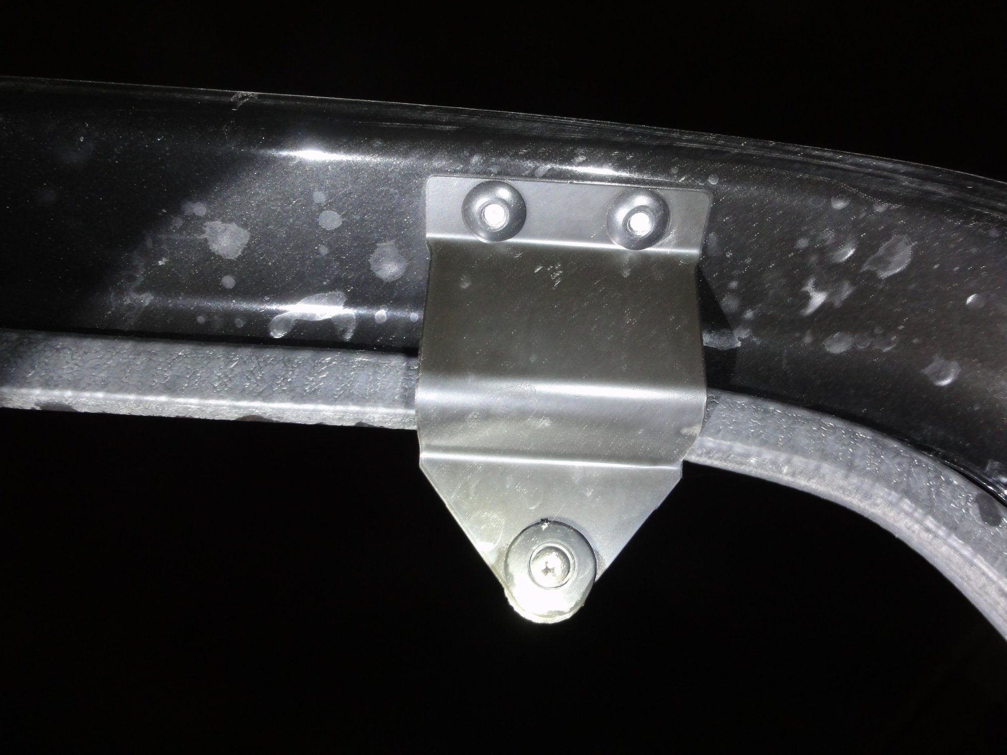

Truck Door, Existing Left-Top Hinge (Riveted)
Truck Door, Existing Right-Top Hinge (Riveted)
Old Dec 20, 2019 | 12:43 AM
dberladyn's Avatar
Joined: Jan 2015
Posts: 898
Likes: 11
From: West Coast
It seems to be pretty simple fix. Drill out the old rivets. Rivet the New Assembly in place. The only problem is that I no longer have a Rivet Gun. I had one thirty years ago, but I think I said to myself one day.. who needs this? They are cheap, I know. I think I would rather bolt the hinges in using something like this Short Jack Nut. Anyone have any other ideas?
The Hillman Group 59126 Short Jack Nut, 1/4-20-Inch
Forget the Phillip Screws in the Photo. They seem impossible to remove, especially without damaging the finished smooth nut on the outside of the glass. Which is probably why they just sell these as complete assemblies.

i own a glass company.....no need to drill the rivets for the latch.....you can twist the latch out of the mount and use the old mount connected to the door.....as for the hinges....bolts and nut serts are a great idea....if you want to separate the hinges from the glass be-careful because the factory Phillips screws have blue locktite ...the best way to separate them is to use a 1/16 drill bit in the center of the Phillips screw. dont drill all the way through to the flat outside nut. this will heat the screw enough for the locktite to let go but leave enough of the Phillips screw to still turn it with a screw driver...then disasseble the hinges being mindful of the placement of the plastic round spacers......when you assemble them the flat outside nuts are keyed to the plastic inner spacer..............the nutsserts will be much easier than going through all of the above problems
