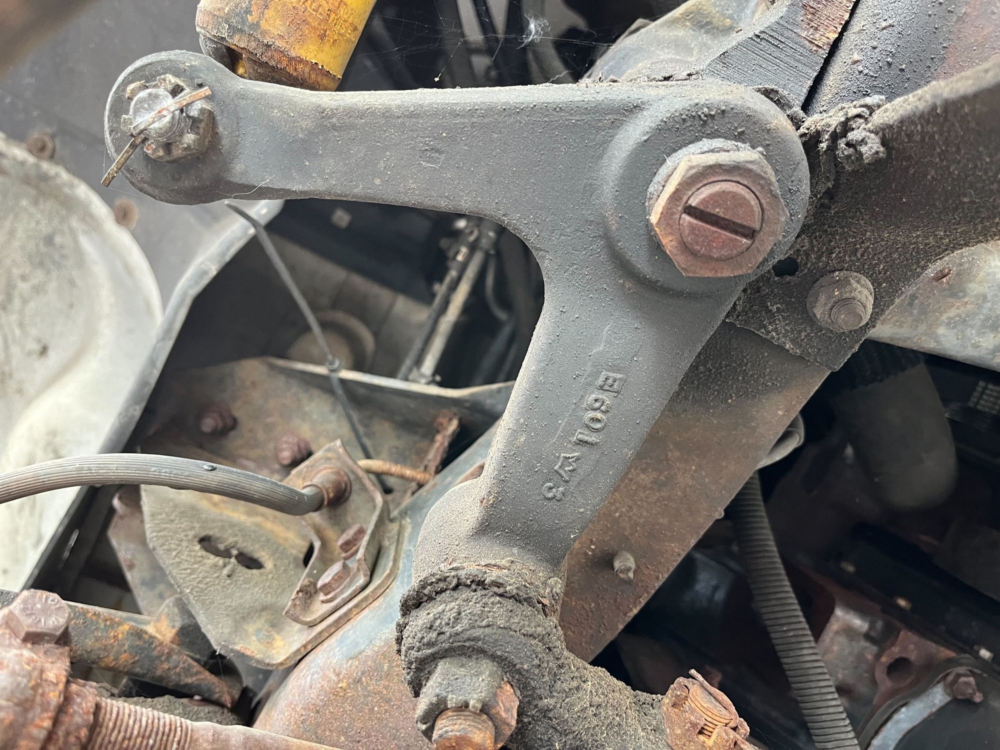

So I did end up finding one, and it shipped to me in good condition. I am now running into another problem trying to find parts. This van has heavy duty steering with two idler brackets with a drag link from the steering gear and two v-shaped idler arms. Drivers side pitman arm connects to drivers side idler arm, passenger side idler arm connects to a steering damper. These parts are getting loose and would like to replace with new but the problem is I can't find a single parts diagram for this steering system anywhere in existence! I've searched through all of the 90's chevy and GMC parts diagrams for all light to medium duty fullsize trucks and vans and none of the parts seem to match what's under the front end of this van. The guy I bought it from said it was a rare van, I'm starting to think it's rare because they never documented any of the steering parts on any parts list anywhere
Has anyone seen a setup like this? Where can I go to find parts? It's a flipnose van with independent front suspension. Everything I have searched for does not list an idler bracket at all for this van and the idler arm looks nothing like the one I have.
