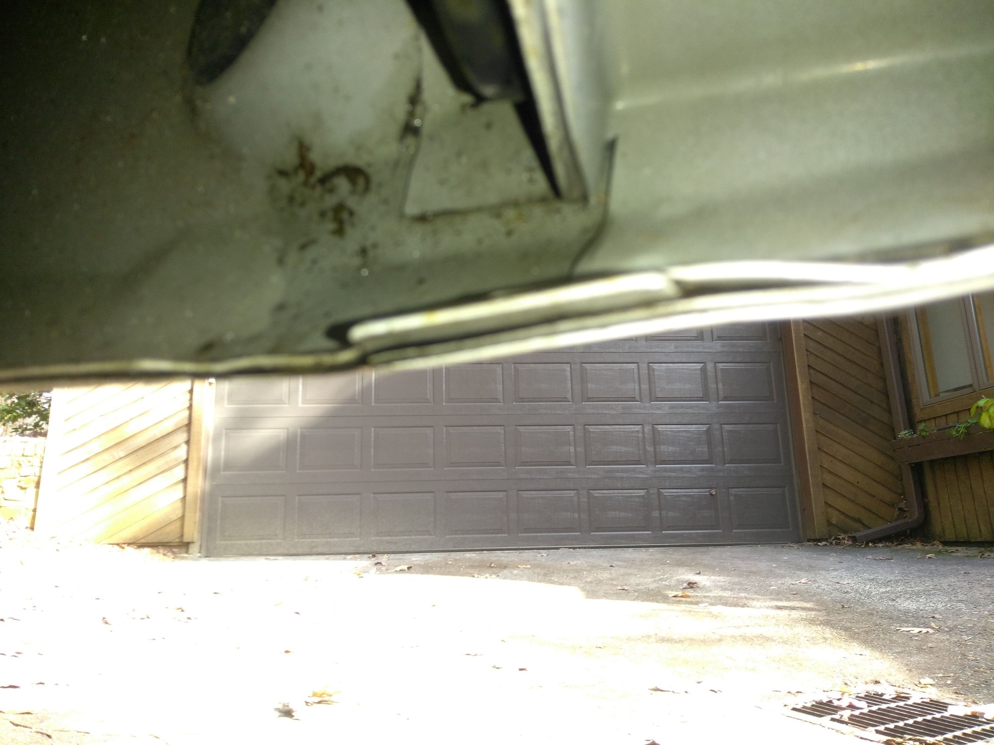

Today while backed down a hill again, I had water dripping the entire day from the body panel seem just above the tail pipe. I have checked the weather stripping on all the doors and they are all in place and still look new. I have noticed since I have owned the van that the sealant on the gutter area or where the sides meet the roof that it doesn't look like it was done from the factory and also found the same looking stuff at a welded seem under the cargo mat. I wonder if the previous owner brought it to the dealer and they did this as an attempt to fix it but didn't succeed. I had a 2000 express and the roof sealant was smooth.

I'm sure it's factory. Welcome to the new GM.
So what are you going to do?

Still working on it, I think I am going to have to take some of my shelves out of the back and fold back the mat and start running water on top and go from there.
