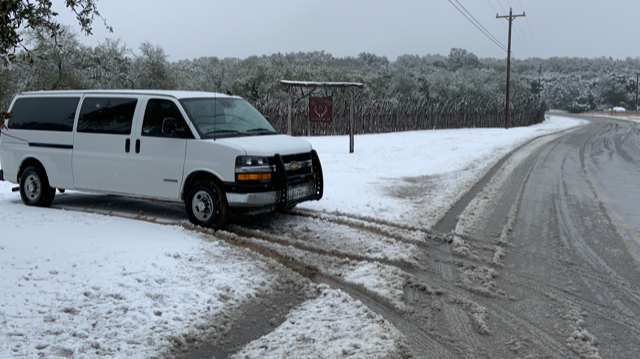

No problem. I would just go over the major grounds at the chassis and engine block. Those would be most prone to rust issues. Believe it or not, I drove my van in the snow just weekend in central texas and almost got it stuck on a hill on a dirt road covered in three inches of snow. Im liking those tires you got on your ride. Do you like them?

Yes, I've since updated the tires to some Sumitomo Ice Edges for the winter(not pictured) as its definitely needed in CO. Glad you were able to survive the snow in TX, that's a rarity. The pictured tires are Toyos that I keep for the summer and are great, Doesn't hurt to have a 3 inch lift on the body, too!

both sets of tires are 31's and rub a tiny tiny bit on the frame up front when turning the wheel all the way, but help huge for anything offroad since she's only 2wd.
