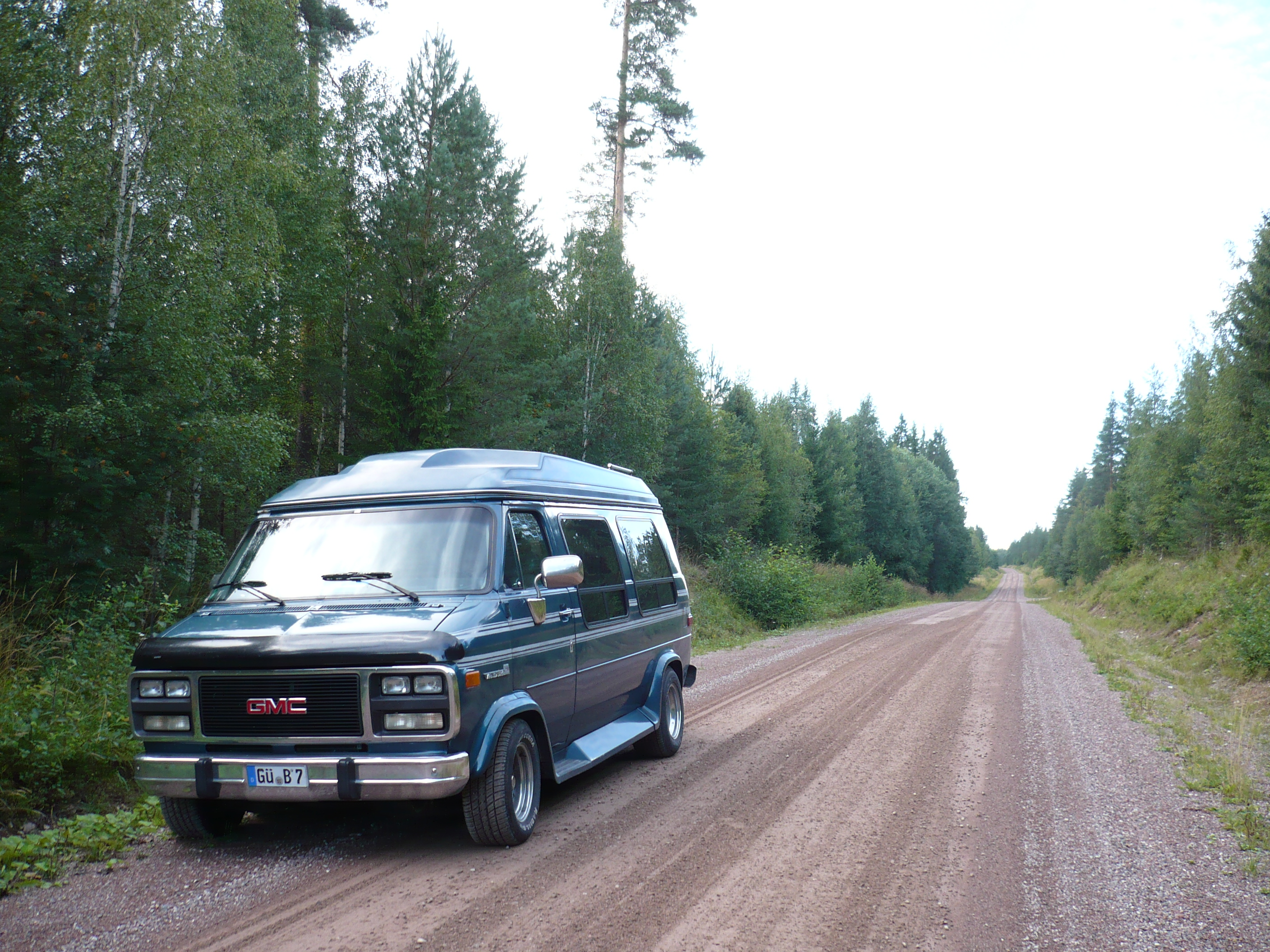

Pls see below a pic of my 1992 Vandura with 350 cui gas engine. No 4 wheel drive. Also I have marked the u-bolts in the pdf file in a red circle.
They are possibly standard u-bolts?

Nice van.
