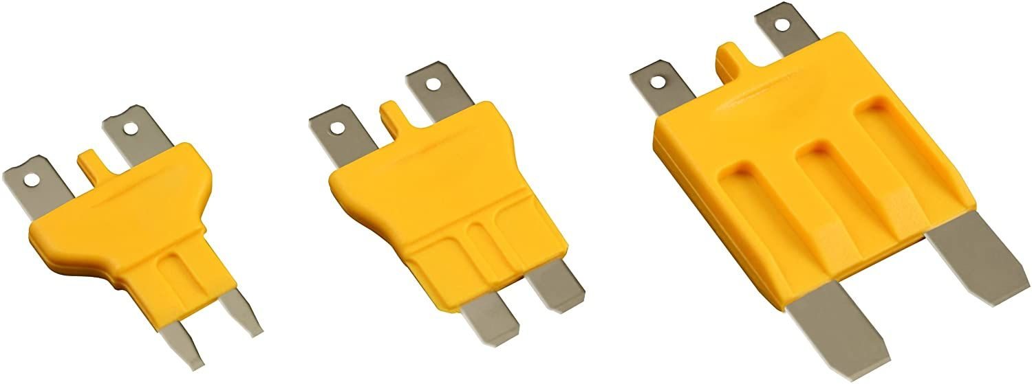

picture of fuse extender , is there a cheaper way , these are over $10 on Amazon

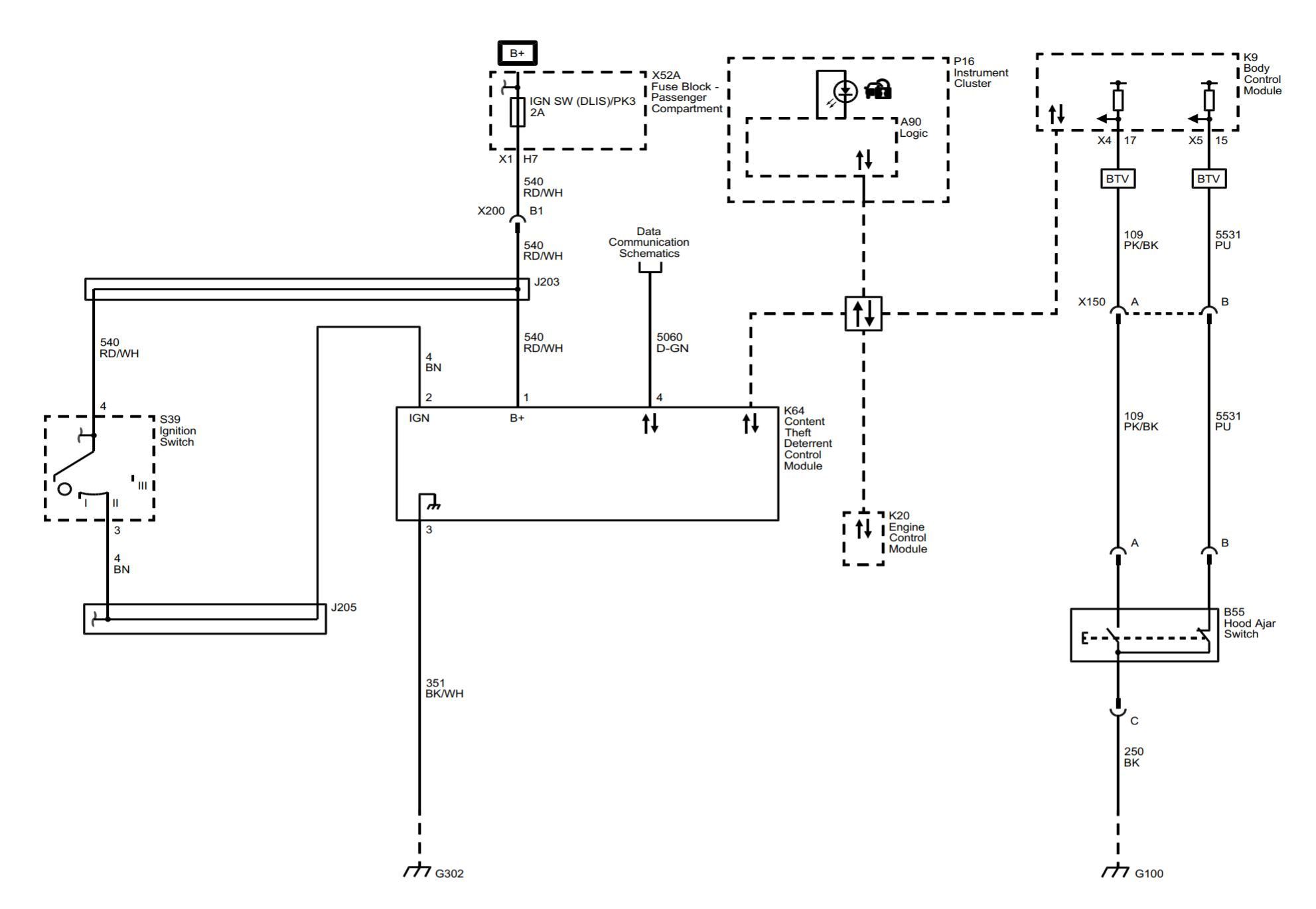

Your van's VTD system already disables the fuel injection system. The only way to disable security is for the correct key to be sensed. Punching the lock won't disable it, and forcing the cylinder to rotate won't disable it either. Doing this will only trip the tamper switches. If the thief is skilled and equipped enough to know how to bypass a Passlock system, then he's not going to be stopped by a fuse.

The lazy way would be to just pull one of the ECM fuses, plug a couple leads in, run one through an inline fuse holder, and then to a toggle switch somewhere. It would slow a thief down as he has to figure out why it's not starting.

Yes it's a dumb key, but the fuel system is still disabled. Passlock wasn't optional. All 2002-2005 vans are equipped with it.

They all disable the vehicle since around 1995. It says so on the first page of the article you linked.
https://my.cardone.com/techdocs/PT%2077-0011.pdf

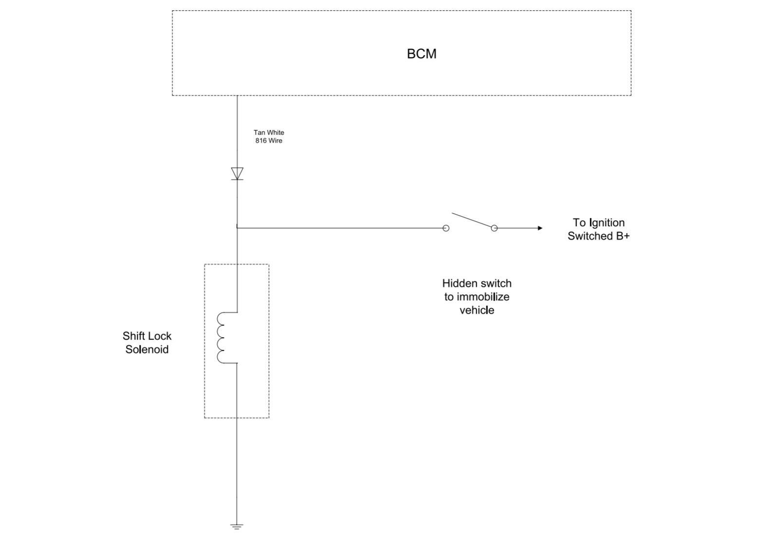

Old Jul 7, 2021 | 5:54 PM
dberladyn's Avatar
Joined: Jan 2015
Posts: 898
Likes: 11
From: West Coast
I forget where I found this, but this is an immobilization point.
My advice is to read the Upfitter manual for your year.

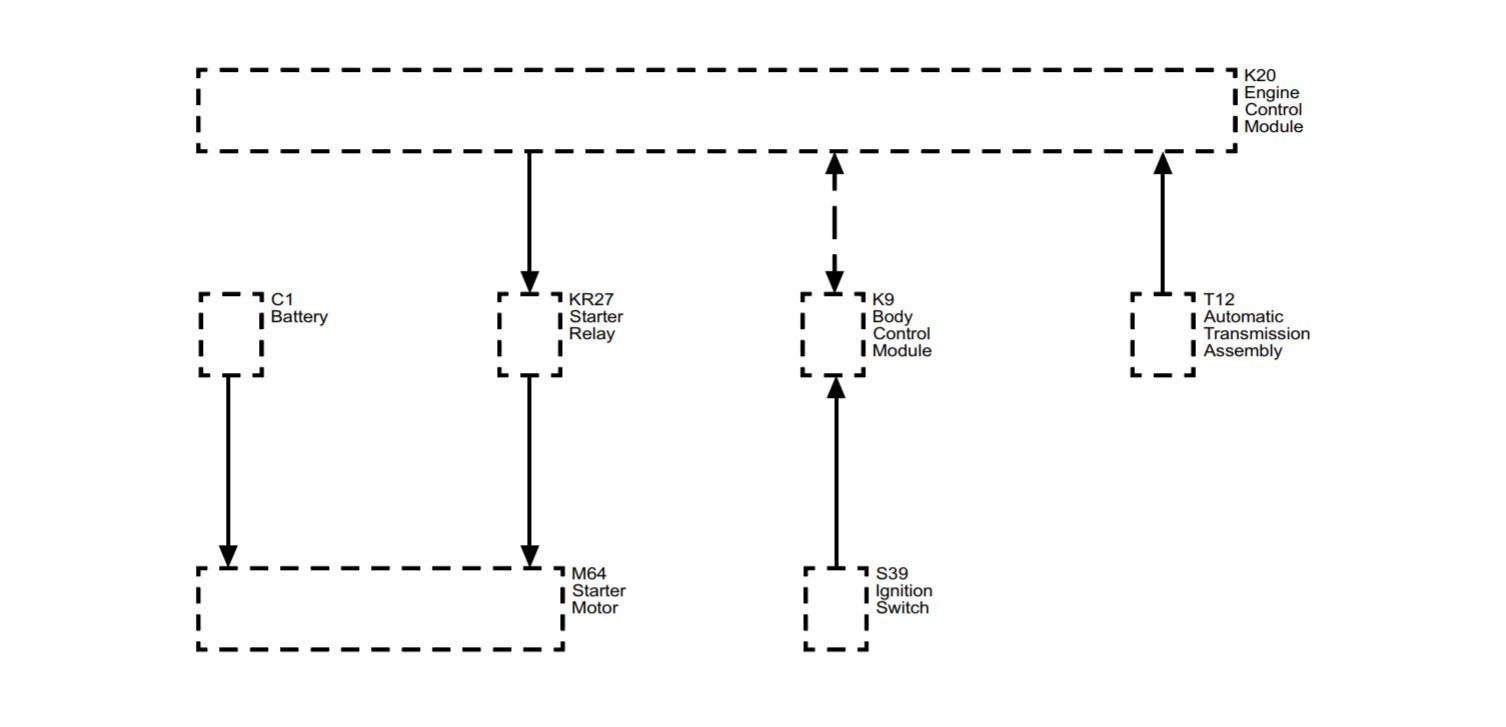

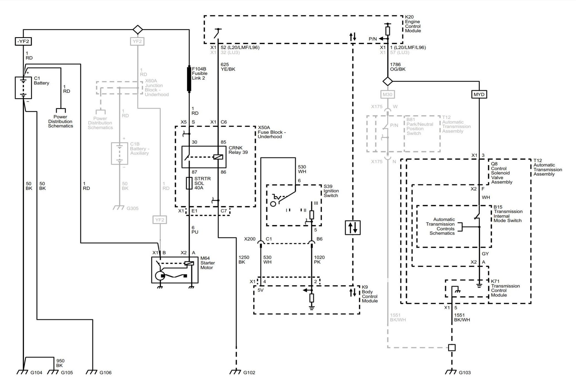

Starting System Schematic
Starting System Logic
