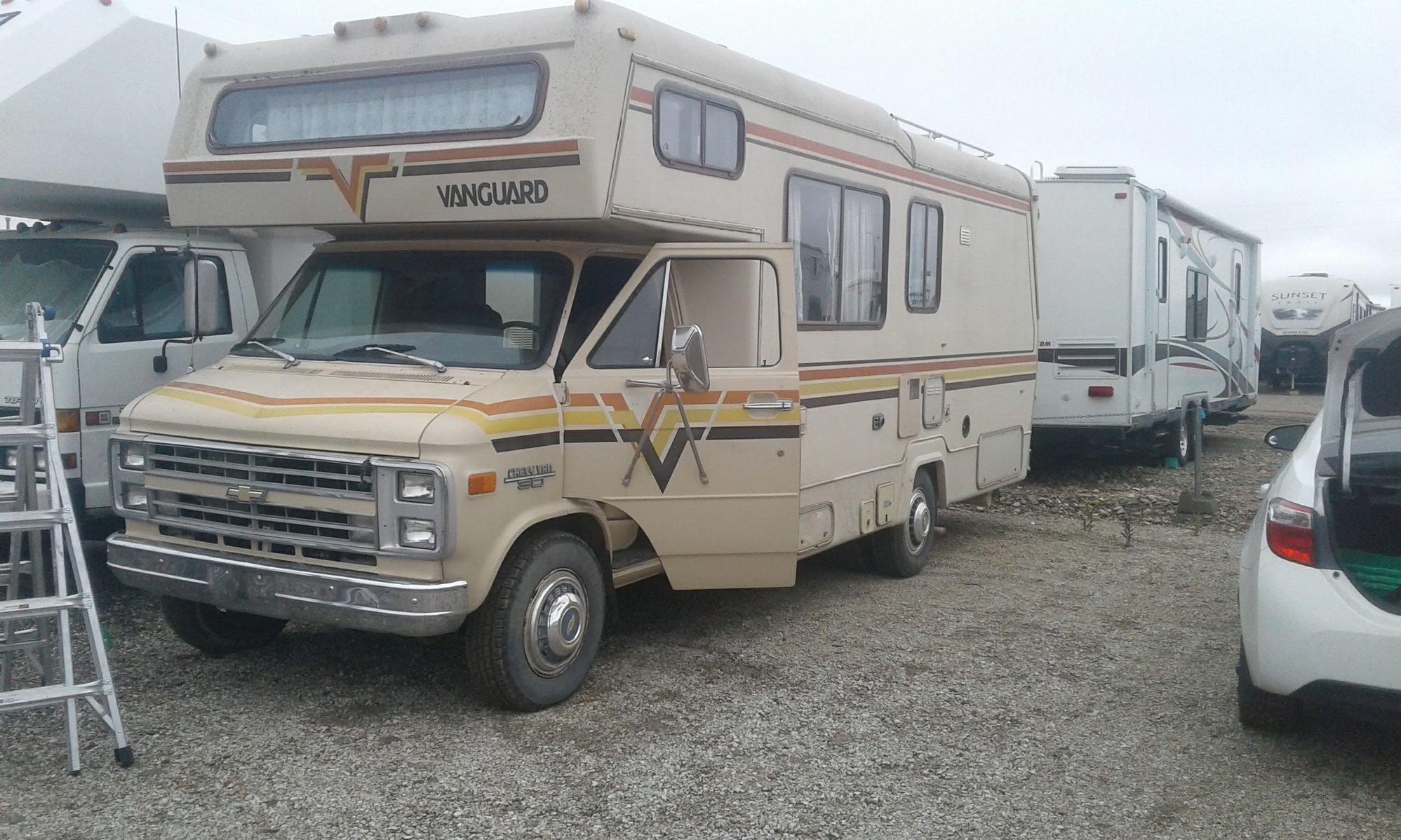

Default 1985 5.7 v8 smoke black. Any guesses?
Got black smoke from tail pipe.
