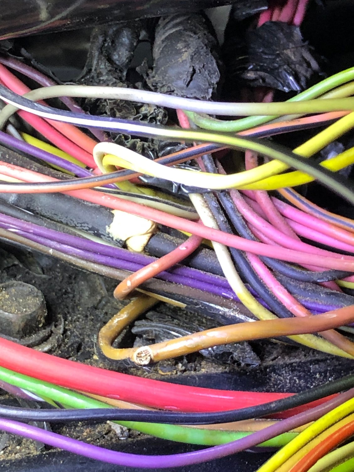

Default Found this grounding hot wire, no 3 4 gears or code, I think it gets kick to limp
Originally Posted by Steven Frasca
Solenoids either work or don't. I have the same problem and I definitely am suspecting wiring harness or loose wiring connections....

Originally Posted by tinybird
where was this wire you found? I'm having the same issue and truly believe it's a short or grounding problem.
