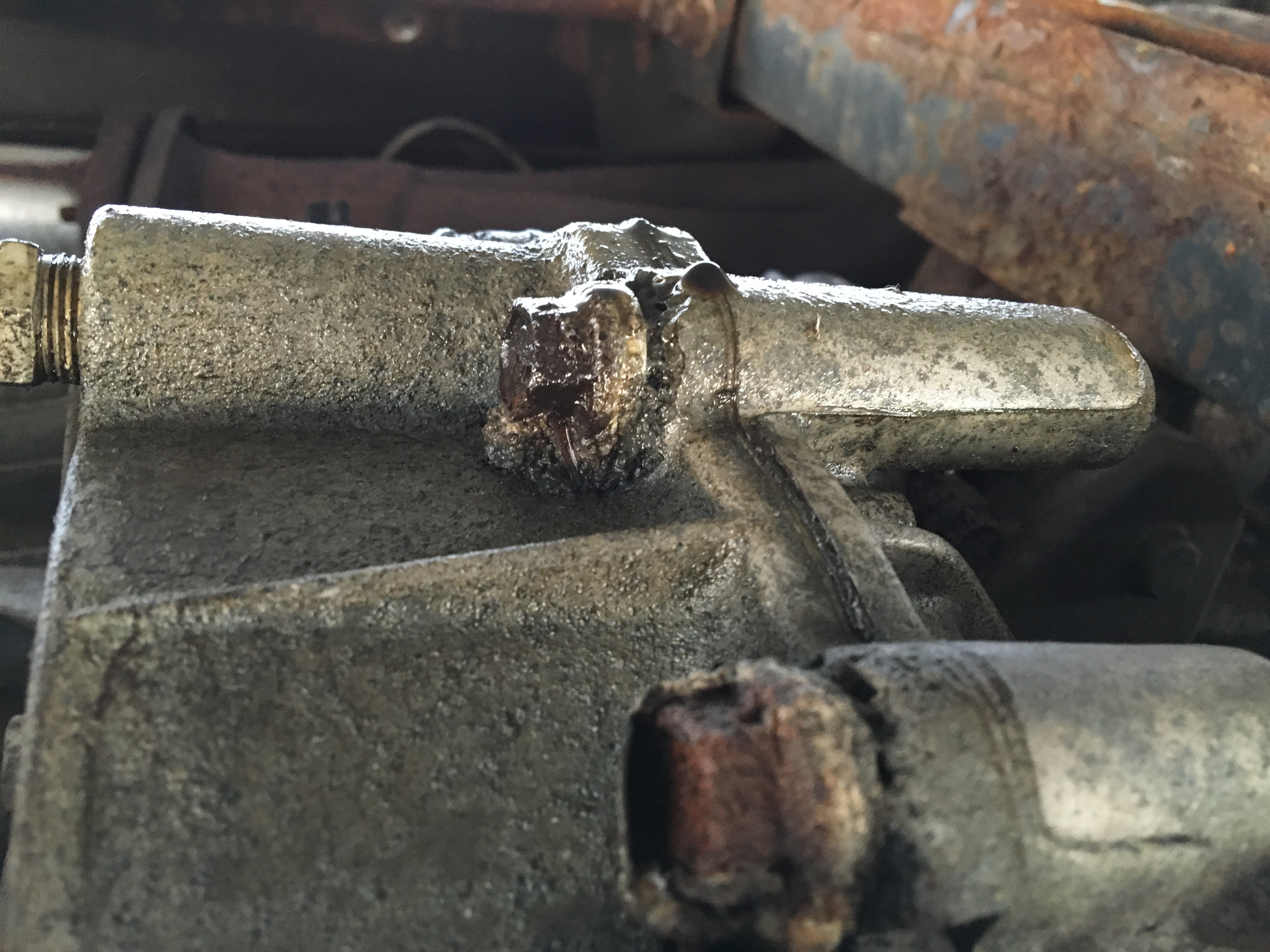

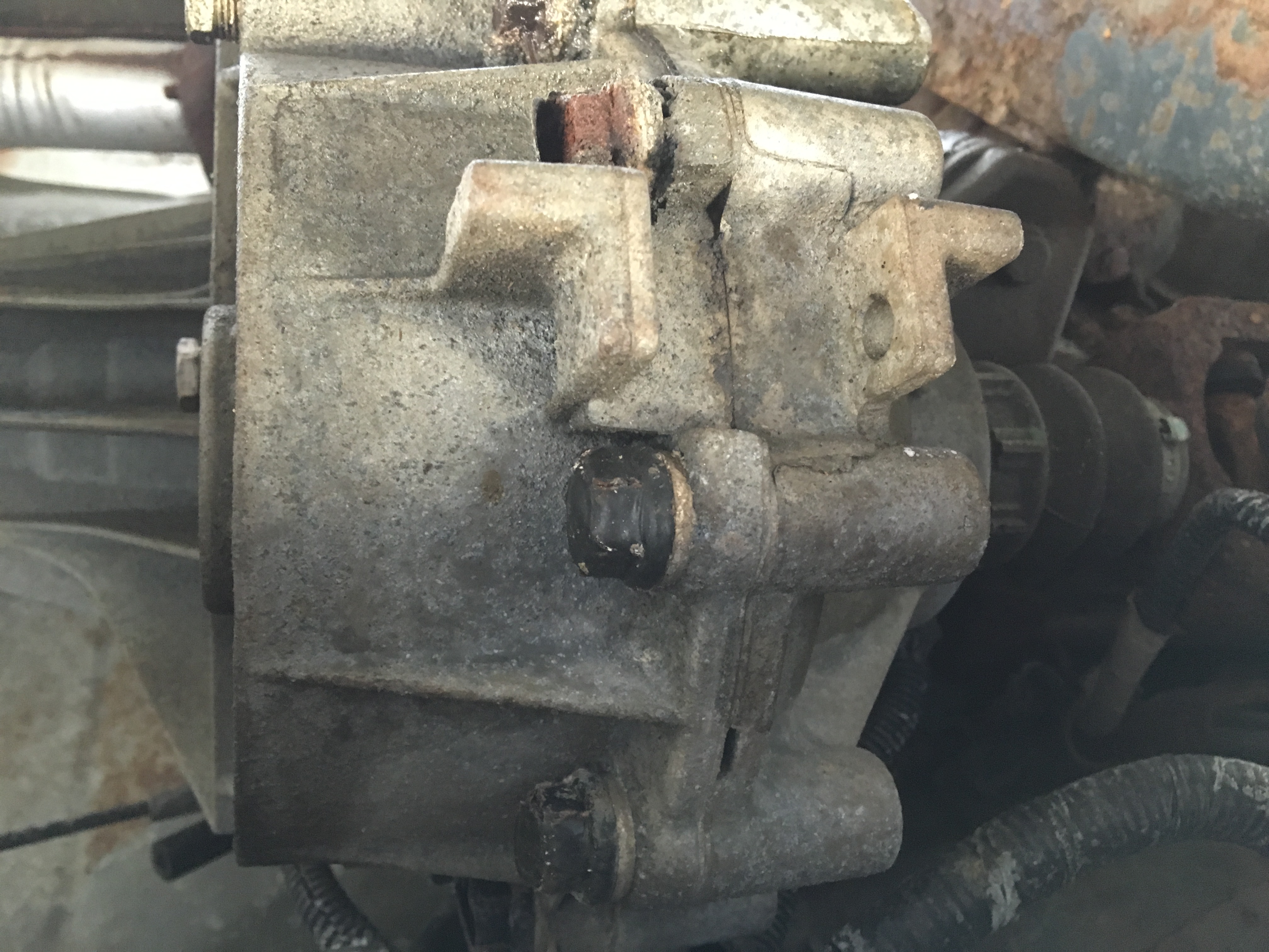

I've been trying to upload pictures for a couple weeks but they never show up. Fingers crossed...
Attached Thumbnails corroding transmission / transfer case-img_0751-copy.jpg   corroding transmission / transfer case-img_0755.jpg   corroding transmission / transfer case-img_0751.jpg

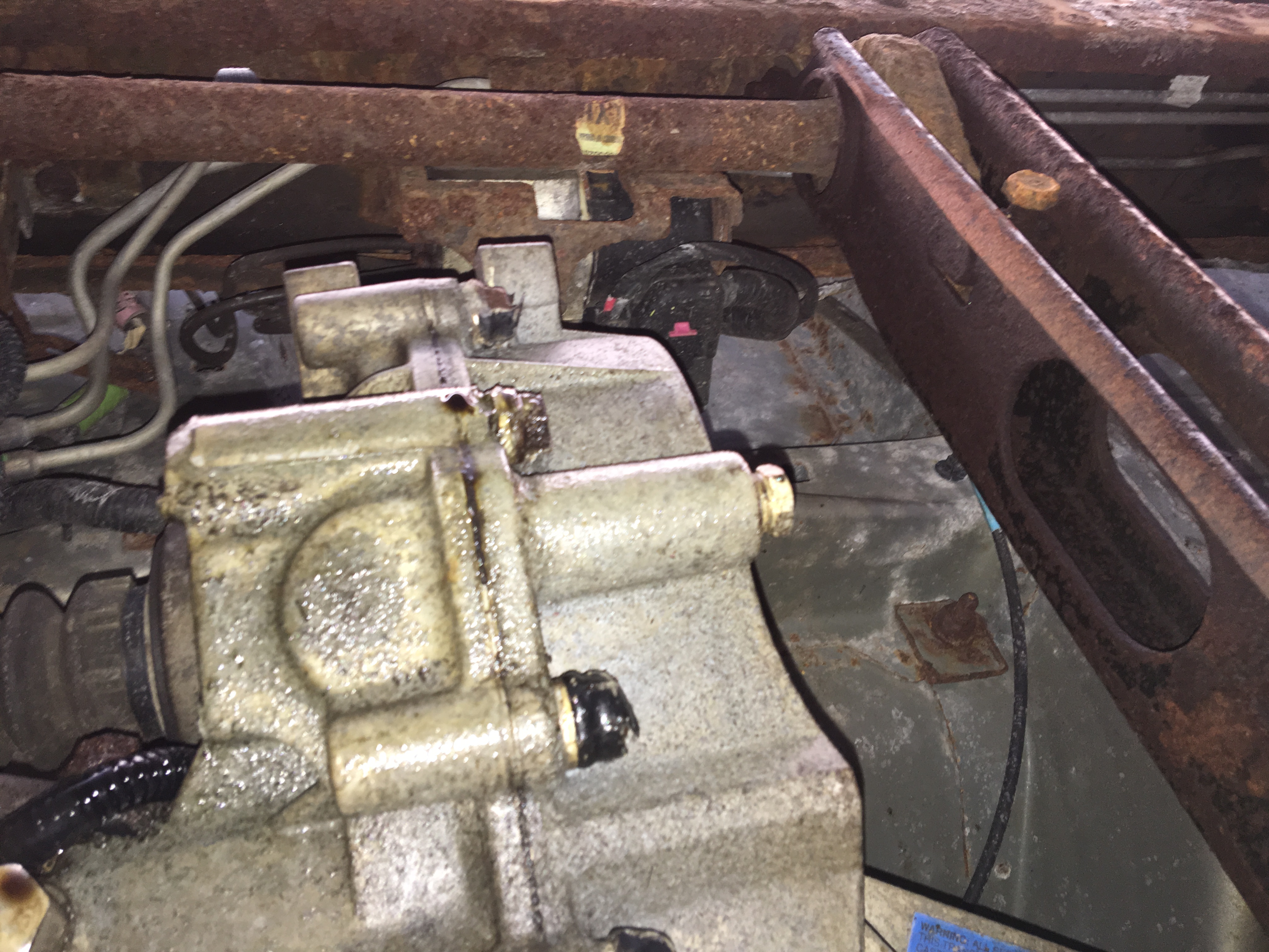

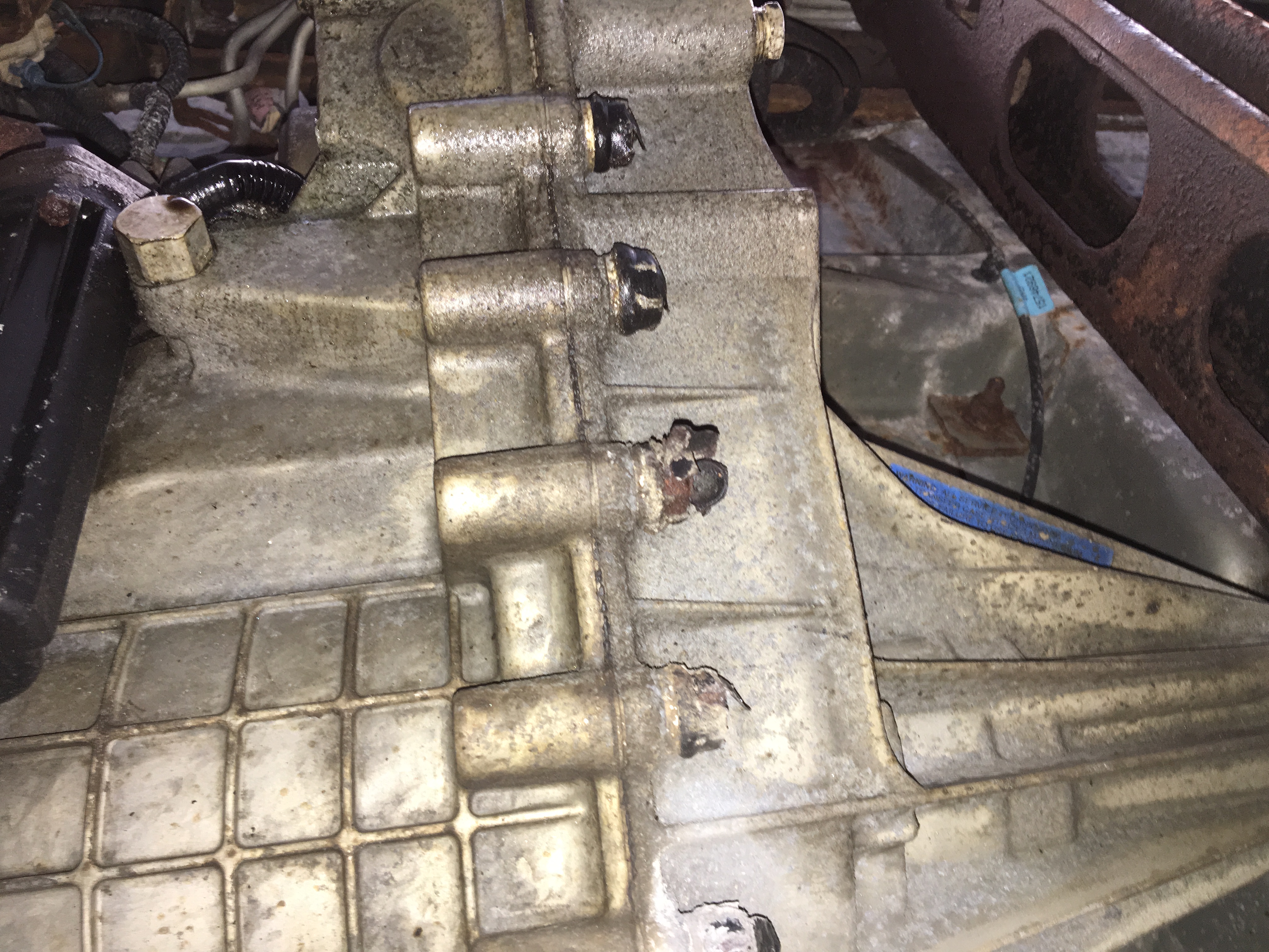

Default more pics
Thanks for your advice!
Attached Thumbnails corroding transmission / transfer case-img_0752-copy.jpg   corroding transmission / transfer case-img_0756.jpg

the leak is from the transfer case itself, not the t-case to trans adaptor.
if it was mine I would separate the case and reseal it. the old sealant will leak after that many years.
google brny case repair for a video to split and reseal the case. Install a new oil pump retainer while your in there. install a new t-case to trans adaptor gasket. the fluid colour looks horrible.
