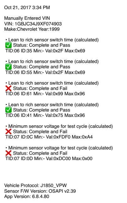

Relooking at the mode6 (pasted below), 2 codes were for the MAF actually. Amazing how much I forget in 2 weeks, sorry. I cleaned the MAF but no change (didn't look dirty, appears normal as far as I can tell), prior to tearing apart. The other mode6 code was downstream O2 sensor, figured I'd just go ahead and replace them so that I can pass inspection, and figure if 1 is going the others may not be far behind (wan't optimistic it would change much but figured it wouldn't hurt).
