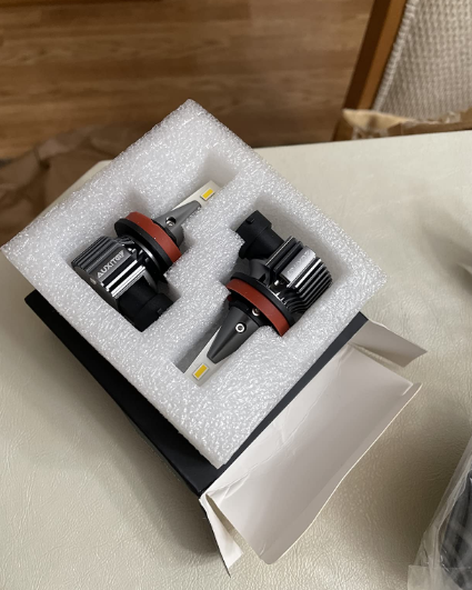

I installed these LED fog light bulbs on my Cobalt about 6 months ago. The install was very easy and the controller will fit inside the watertight housing in the original headlamp without any modification. no flicker. Note, they have a rotating ring that will let you adjust the orientation of the bulb, I did not catch this when first installed and one of my lights looked funny. they need to be installed so that the LED lamp portion are facing parallel with the ground not perpendicular to the ground. it only took about 5 min to take it back out and adjust once I figured out what was going on. the install time could have been as quick as 10 min if I had not watched a youtube video on how to do it. it took me forever. the Driver side is a very easy 5 min job. the Passenger side is another story...
