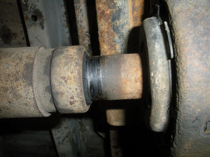

Hello everyone, To replace a u-joint, I removed the driveshaft. On reassembly, I slid the yoke into the transmission as far as it will go and caught it at the center bearing. (0.39: see photos). Is this a problem, do I absolutely have to leave this 0.39 in the transmission or is it good like that? Thanks a lot for your answers.

It's ok; i loosed the central bearing and move the shaft back one centimeter. It's ok; Thanks !
