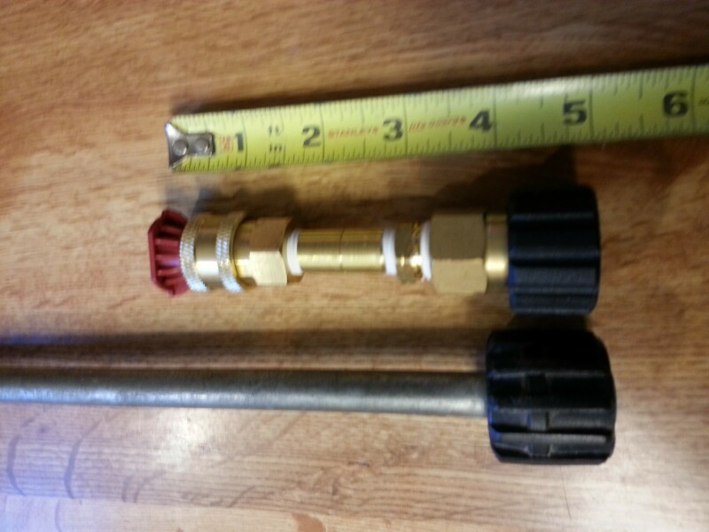

I have been searching for a shorter wand to use on my pressure washer so that I can more easily get underneath my vehicles....
I could not readily find anything so a trip to Lowe's and about ~$23 worth of parts I now have a stubby wand attachment
The normal wand extension is about ~21 inches my new one is 5 inches...
The total length with wand and handle was 44 inches! now its 24
3/8 female pipe thread to pressure washer adaptor
1/4 female QD connector for the nozzle attachments
3/8 to 1/4 reducer
1/4x 2 inch nipple, (I could have gone shorter on the nipple)
Warning: with the shorter extension you can easily put your hands in the high pressure spray pattern, Don't do that....
