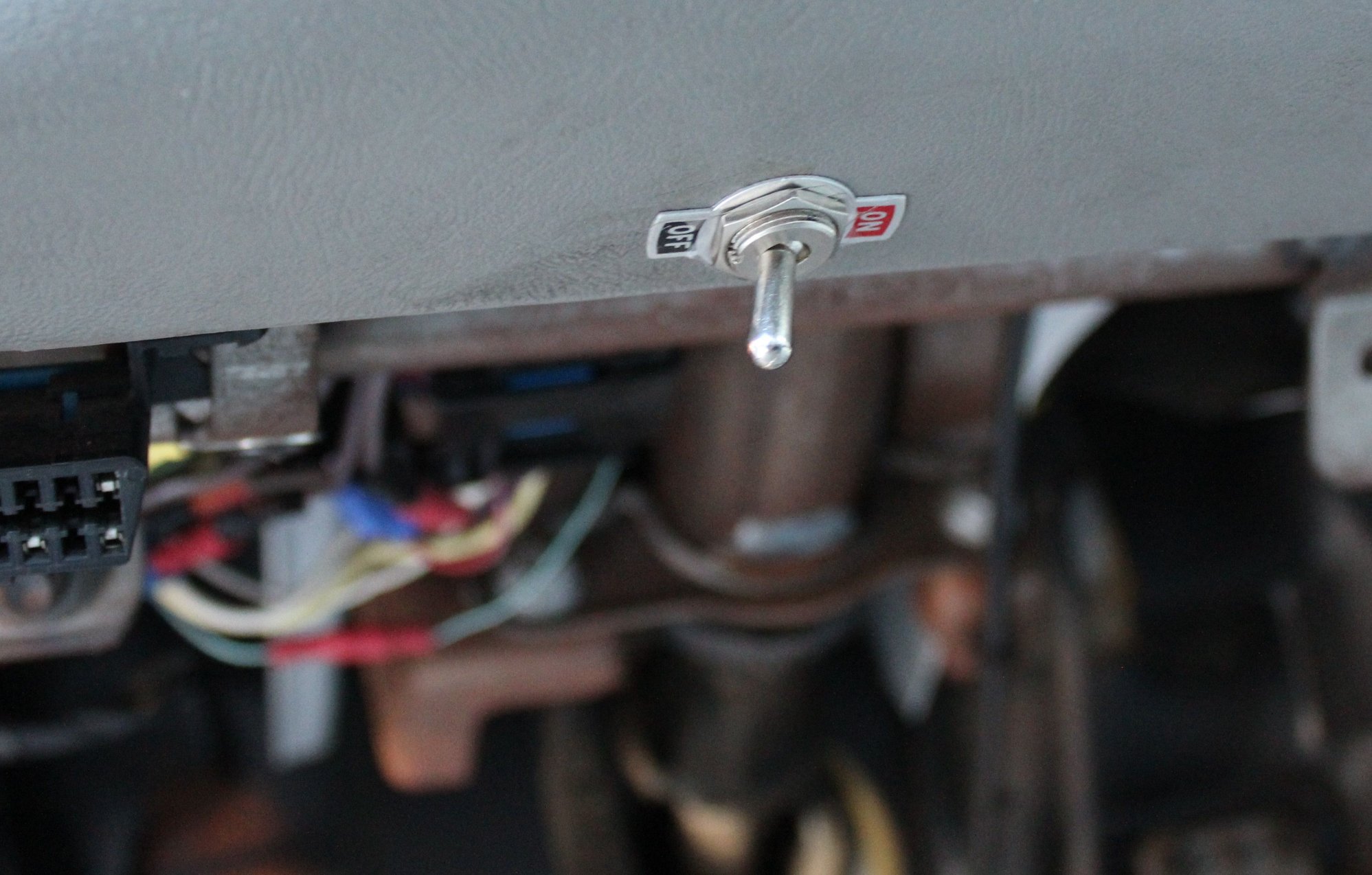

Cut the correct wire that you found in step one and solder the toggle switch in. That's pretty much it if you're not going to use the time delay relay.
The problem is that my suburban needed the toggle switch to be on in order for the torque converter to recognize the brake pedal (maybe someone could clear this situation up on the tread). After 30 secs or so then I could turn the toggle switch off and the torque converter would never lock out. It would think that the brake pedal was being pressed the whole trip (NO SHUDDER!!). Of course, If I turn the car off I would have to turn the toggle switch on.... start the car... wait 30 secs... and then turn the toggle switch off in order to have no shudder. So then came the Time Delay Relay (I will now call it TDR)!

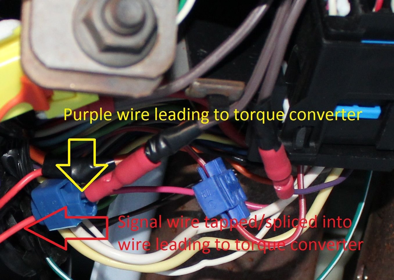

Set the time to approximately 30 secs or so with the potentiometer or digital read out (depending on the TDR) and find the lead on the TDR that outputs 12 volts during the 30 sec count down and then 0 volts after the 30 secs have passed. We'll call this the signal wire. I had to modify my TDR being that it was in a loop repeating the 30 sec count down endlessly (shows in picture which tab I cut). You may have to do the same.
Step 5:
Splice the signal wire into the wire (purple for me) that goes to the torque converter.
