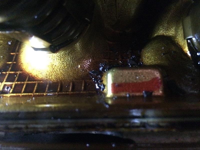

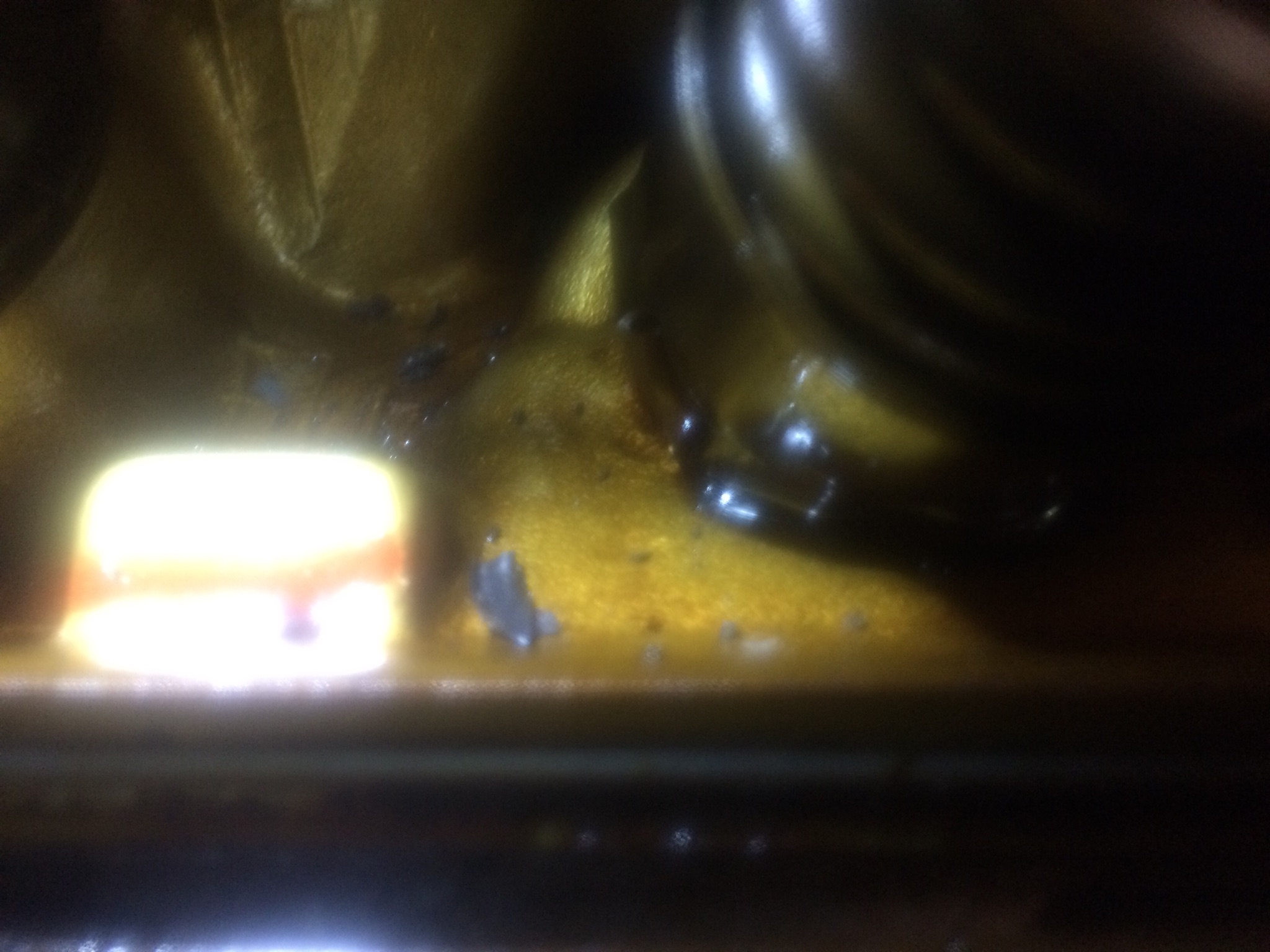

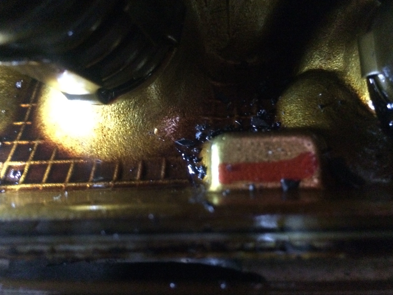

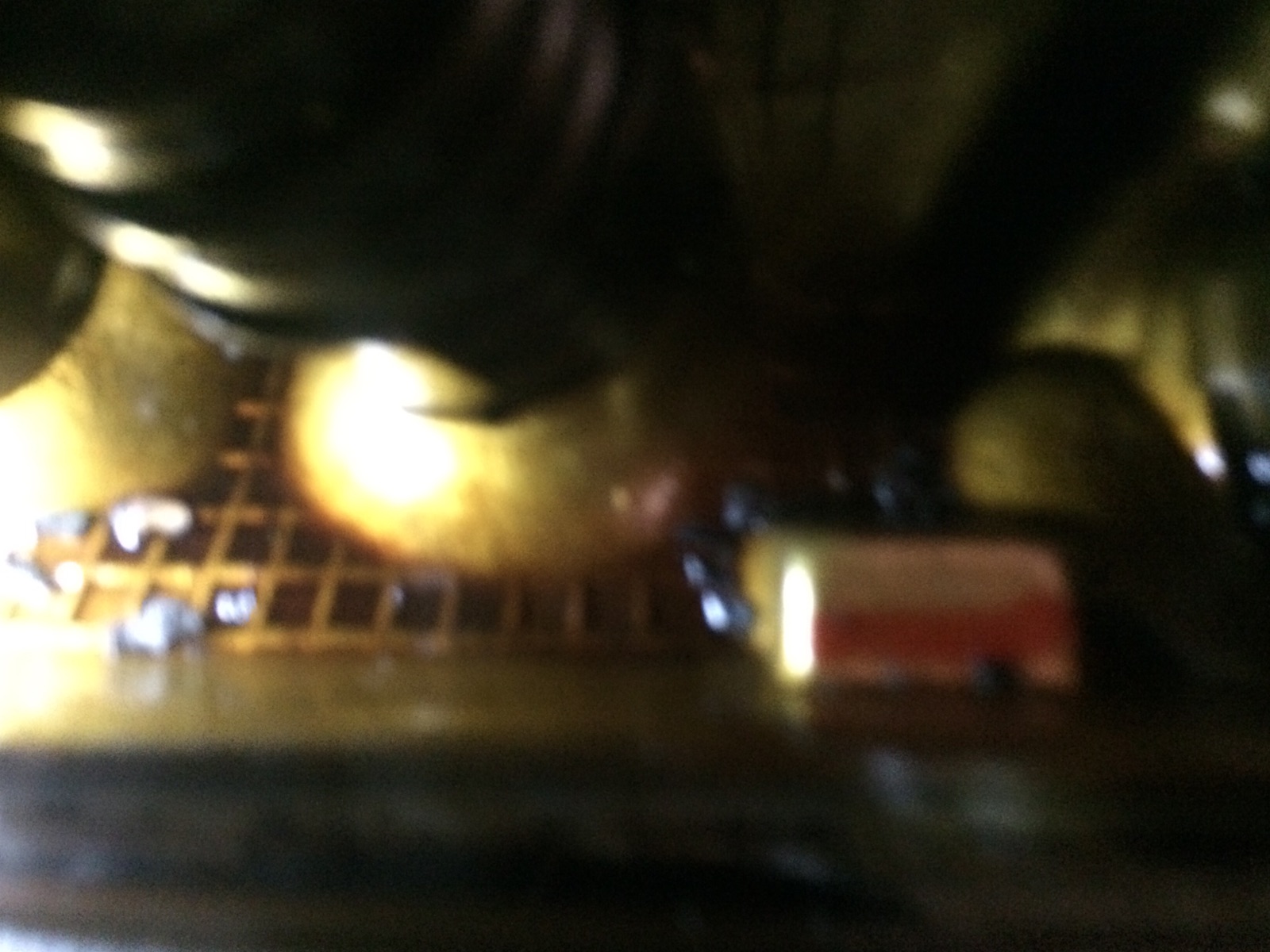

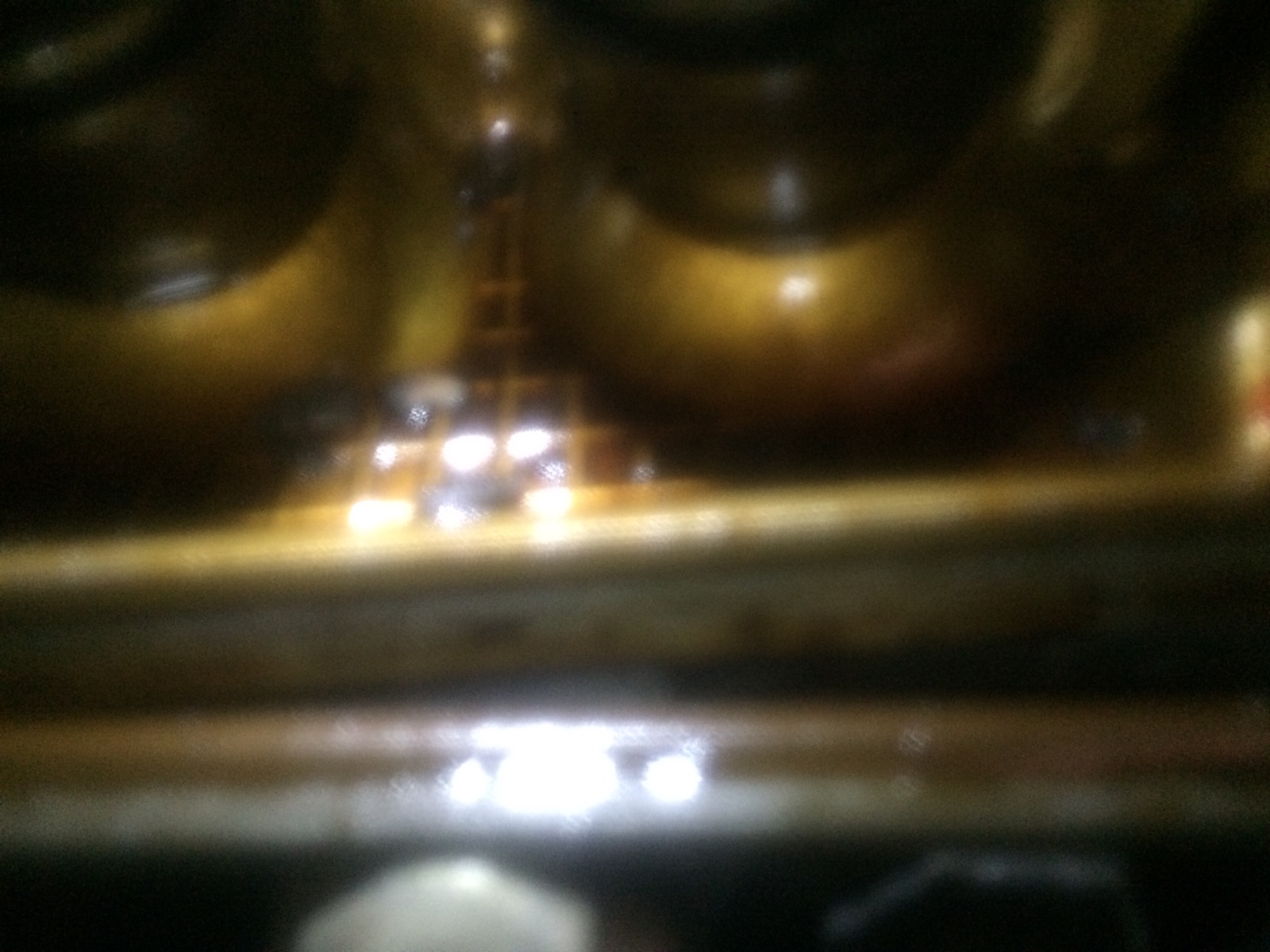

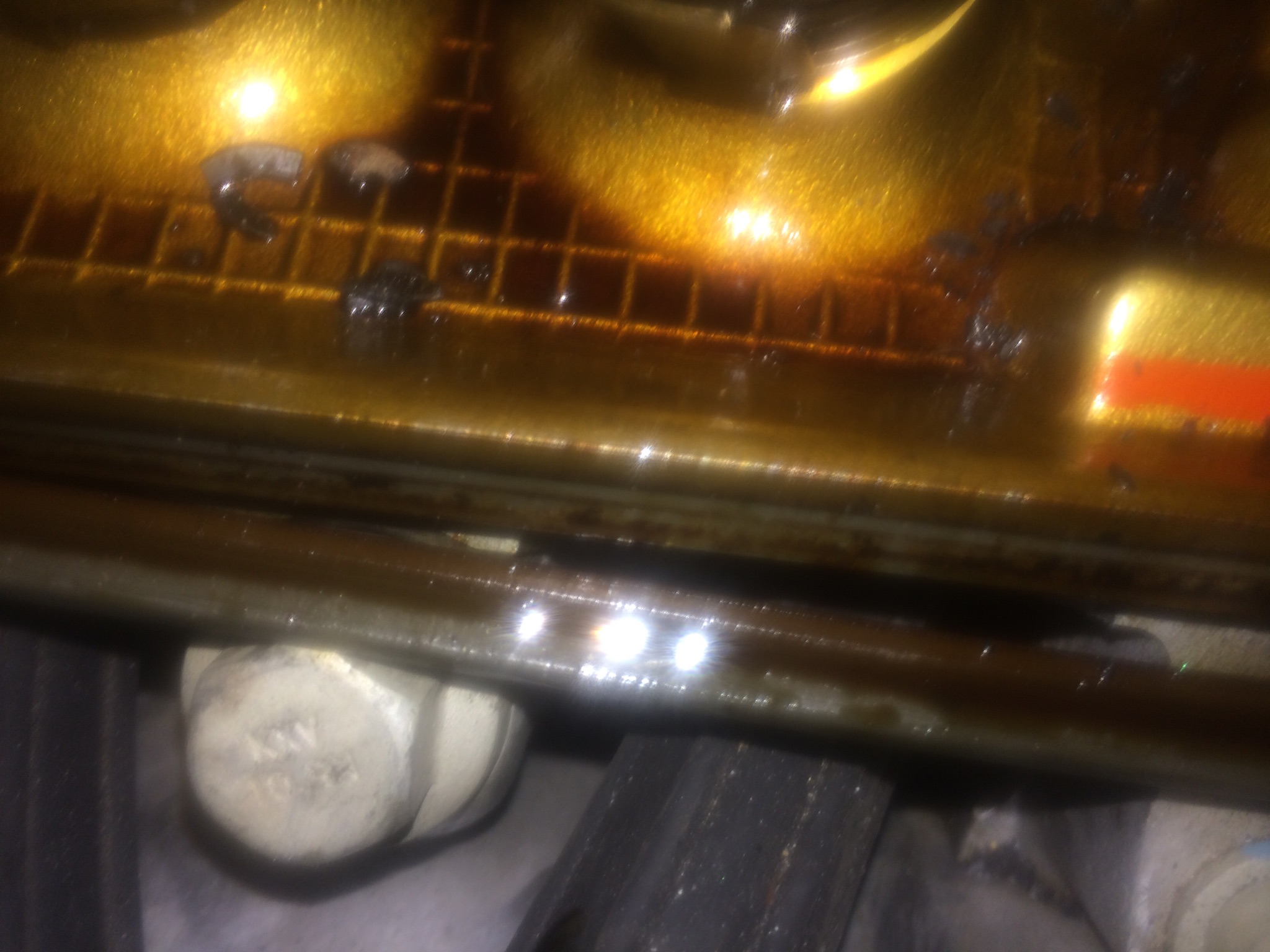

I pulled the rear valve cover today and found small pieces of metal or aluminum on top of the head. The rocker arms had very little play so I do not think the problem is a collapsed lifter. Anyone know what these pieces of metal could be?
