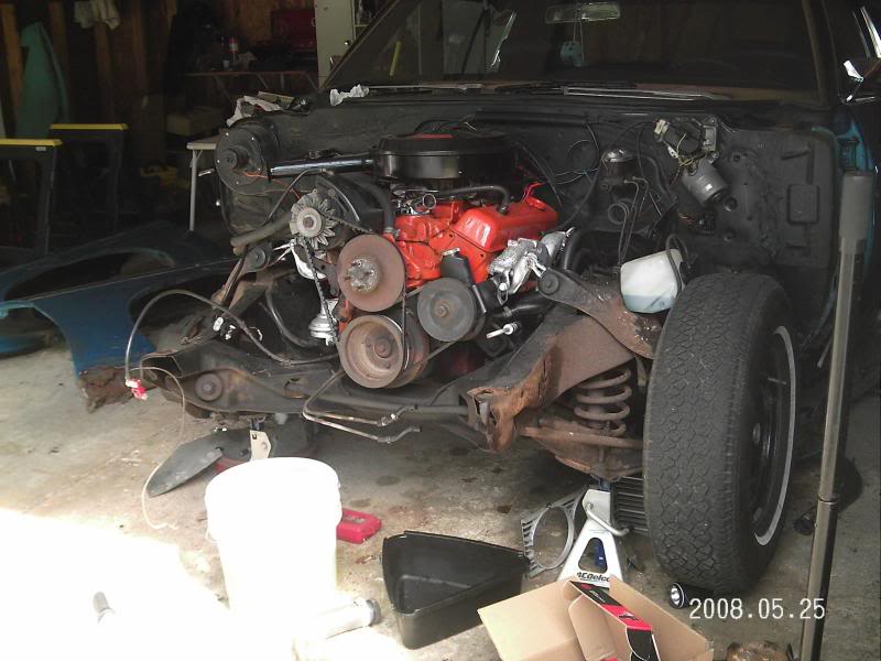

Looking to see about putting these headers...
http://www.summitracing.com/parts/SU...1/?image=large
on this car... 69 Impala 350 V8 automatic...
Any opinions on the part quality? My brother in law has a 94 Mustang 5.0L. I bought the summit brand shorty headers and I must say aside from the swap itself being kind of a pain, that the headers were great quality and fit/functioned great.
Also, any tips to successfully removing the bolts that screw into the head? And with the whole job itself?
My neighbor who is an old school hot rodder (he has a 72 Monte carlo with a 383 stroker) is going to help me install them, but it doesn't hurt to research too.
Thanks!!
