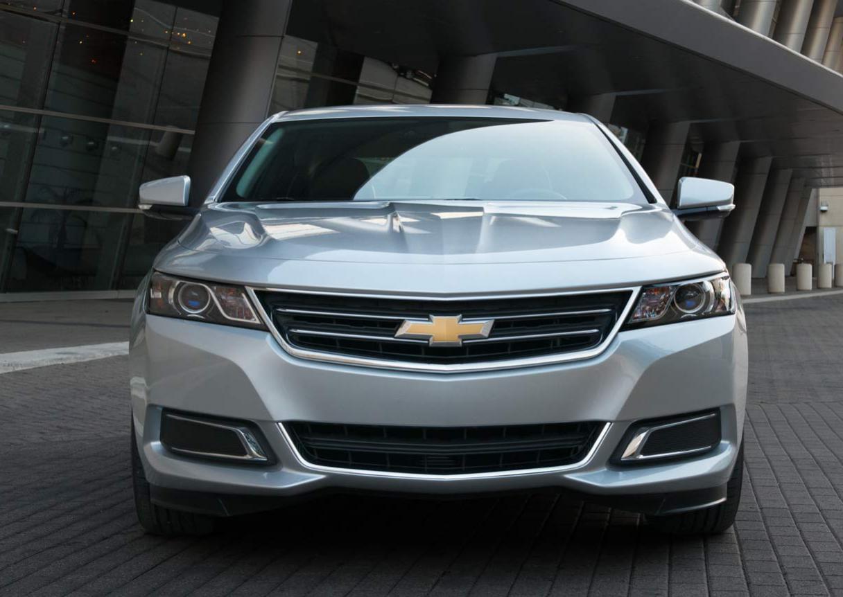

The Impala with Adaptive Cruise & Collision Avoidance will have a distinctively different front grill than other Impalas as the active radar is housed in the grill. I doubt this option will be rolled in with the convenience package as there are a lot of people that do not want it and it is a $1695.00 option.
Attached Thumbnails ACC feature-2014-impala-adaptive-cruise.jpg   ACC feature-2014-impala.jpg
