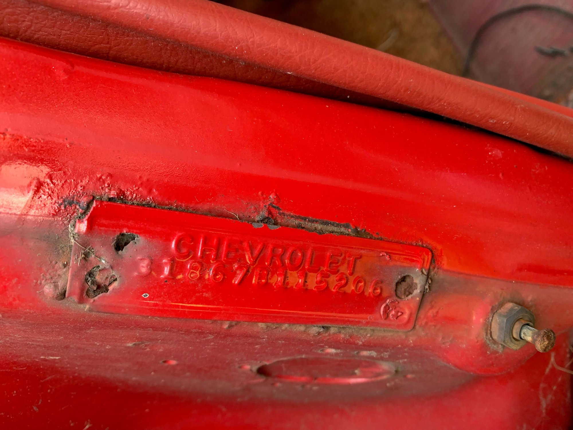

Any info on this vin would greatly be appreciated

The code 1847 is an Impala V8 2 door htp, a convertible would be 1867! The car was assembled the 1st week of May at Baltimore, was Laurel Green with a green interior and Powerglide transmission. The 3P code on the accessory line is unknown to me. The engine size will be determined by the code stamped on the block.
