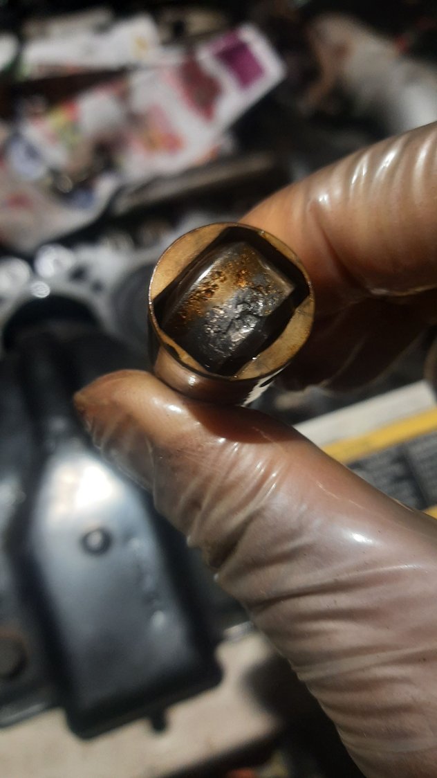

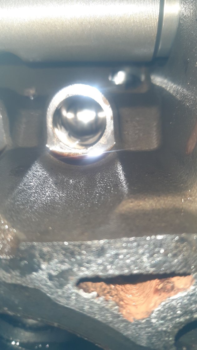

Default Hope it's not too late..? I've found the Problem and it's not pretty..
Hey guys, Its been a long one. But I've found the Problem. The Cylinder #5 Hydraulic Lifter Roller bearing is Chewed up along with the corresponding Cam Lobe.
So, what I wanna know now is, how to go about replacing the camshaft and what is involved? Does the engine have to come out? Which side does the Camshaft come out of? Driver side or Passenger side?
Pics below for Your viewing pleasure..
Chewed up and Well fed.
Lifter Hole Cam Lobe Chewed up.
