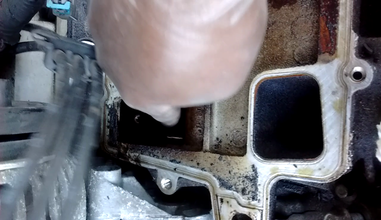

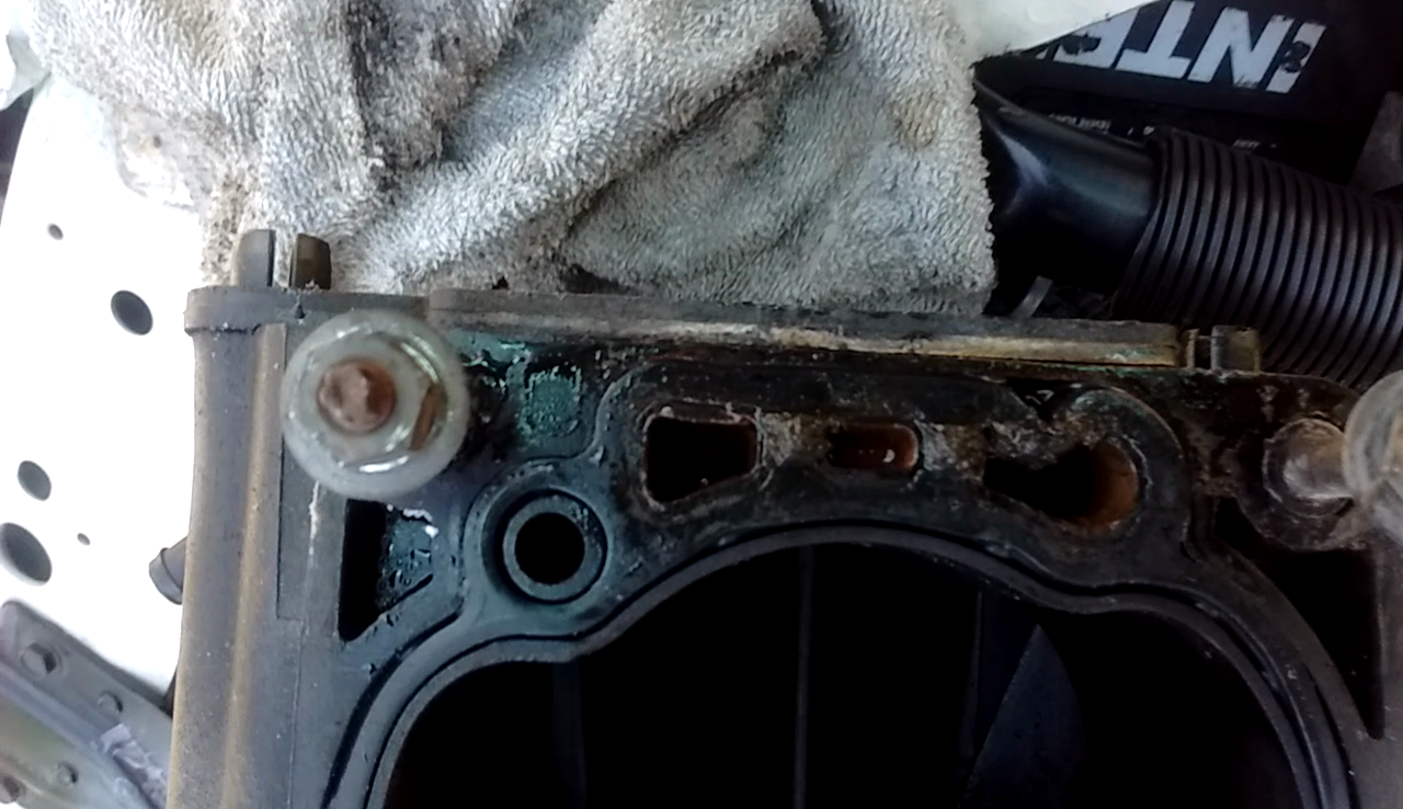

I'm still in the Process of Rebuilding My 3800 Impala Engine After having persistent Cyl 5 Misfire, A little history: I Replaced everything relating to the Cyl 5, But to no avail. So when I opened it up, I found Oil on top of the Lower intake Manifold, Seems a common issue with these engines. My Throttle Body To Upper Intake Manifold gasket Looks Warped from the EGR tube Heat (which I suspected is where the coolant Was getting to the Oil from)
My Rockers and Push-Rods have play in them, (the Rocker Arms Slide from side to side, even tho its not very much, But it worries Me, Also, I can Spin Around the Push-Rods with ease especially Cyl #5 Push-Rods), I haven't gotten to the Rear bank Yet, But I'm guessing it'll be the same scenario back there.
I though of Just replacing the Lifters and corresponding Push-Rods that had play in them (as a cheap fix), but I figured that won't be a good idea.
So My question(s) is, are the play that I'm having in those Rockers and Push-Robs a common thing to see in these engines?
If not : (1) what would be a good way to diagnose what My problem is while I have the engine Open?
(2) What extra step/check can I do while I'm inside the engine to See what else I need to perform a good fix? Is it worth it dropping the Oil Pan and Checking the Bearing for any Play too?
And (3) If I don't need anything else, Will Just Replacing ALL Of the Push-Rods and Lifters Fix This Issue For Me?
Thanks.

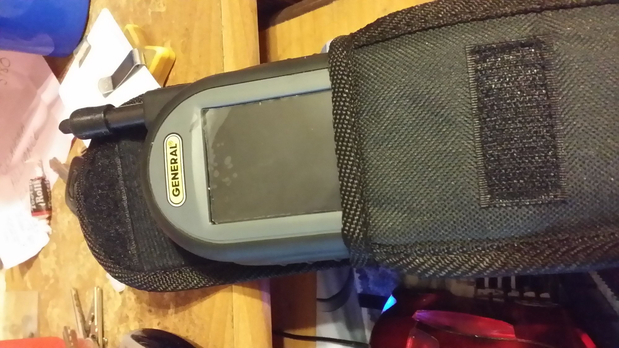

I'm thinking burnt valve. Fiber optics are getting really cheap. Get one of these, inspect through the plug hole.
General model PCS55 video optic<br/>
