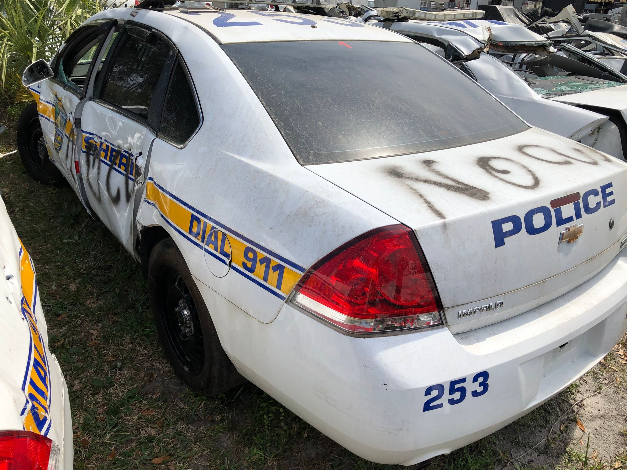

Had some time to mess with the car today. With a new breaker bar and a 6 foot piece of pipe I was finally able to break the axle nut loose. I replaced the knuckle and the wheel is straight up and down now. Even the steering wheel is straight and under the hood the strut is centered in the opening instead of off to the side like it was with the knuckle bent. Hard to believe that inch thick piece of iron could get bent, but it did. Really relieved this problem is repaired. Can register the car and start driving it now. Here is a picture of the car when I bought it and a picture I took monday.
