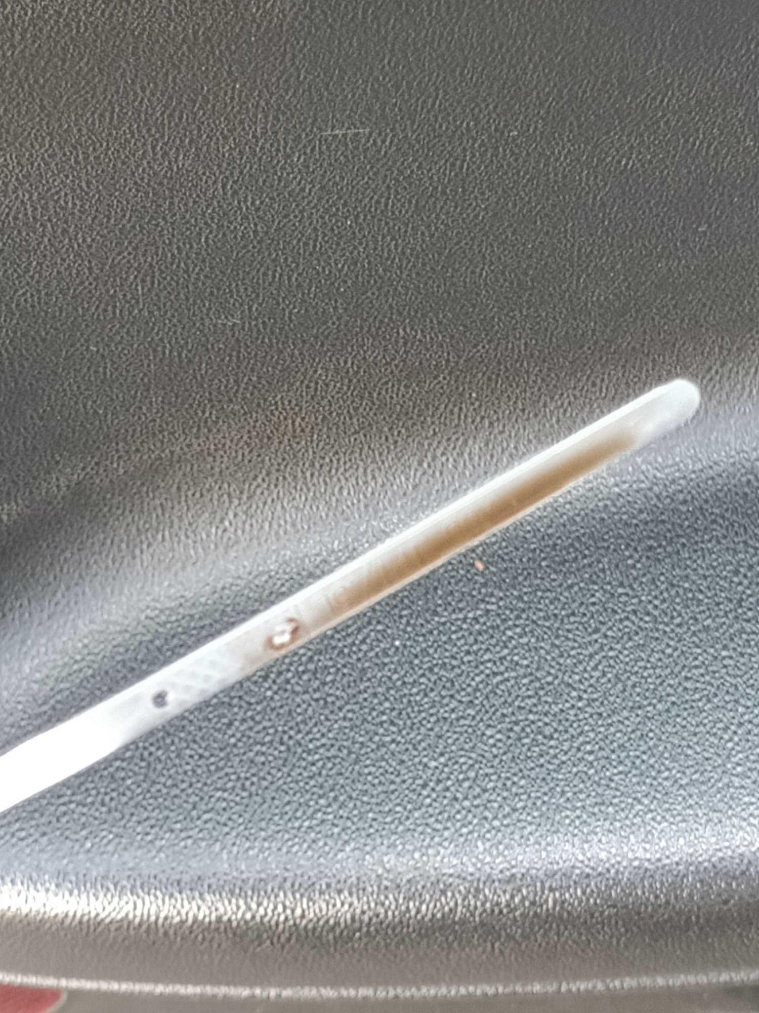

Thanks for the input I mean i just recently bought it anyways it was at 121000 miles. It's now at 126000. I also found that the fluid is like light to dark brown but puddles up at the bottom of the stick which makes a dark brown spot and the fluid is light brown. Question if I add some of that transmission fix would that make it any good for better performance?

Post a photo if you can. The fluid should be bright red, not brown.

This is what it's reading and look like
Old Mar 19, 2024 | 1:09 PM
yeah. Runny , and burnt. That's a transmission that was not looked after.
Driving it this way is going to rapidly accelerate its death. I would be looking for another car if I were you.
