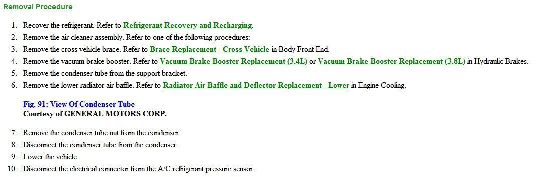

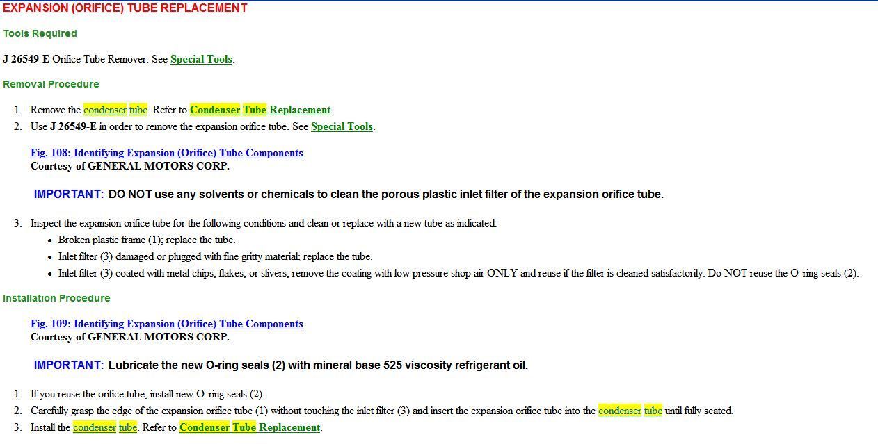

I have the same car - this is from Mitchell OD5
The orifice tube is located in the liquid line between the condenser and the evaporator. #15
