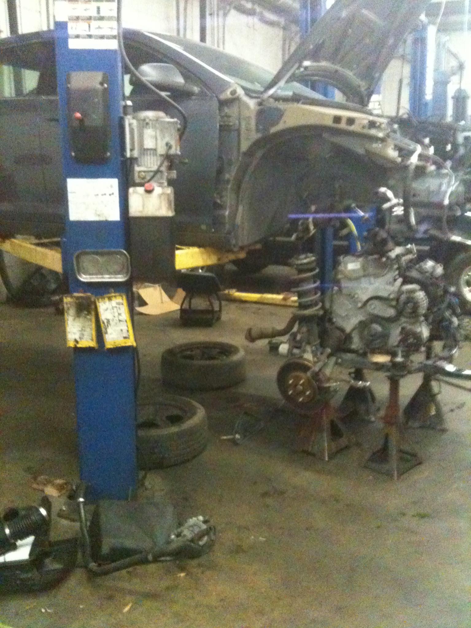

Not to scare scare you by the pictures below. In the pictures below is a 2007/09 malibu. It was in an accident bad enough to crush the front end and bend the passenger side frame rail. After the Body shop next door removed the carnage they brought it over to my shop with a fork lift. I removed the engine/ trans as an assembly. It only took about a half hour (mind you a lot of the front end was torn/ cut off. They took it back to their shop to replace the frame rail. We took the engine and trans out back with a fork lift (shrink wrapped for weather protection) 3-5 days later I put it all back together. It only took about 45min (core support was still gone). When it was done the only thing you tell by looking under the hood was the frame rail was a slightly different color.
The point is the engine and trans drop out as an assembly on the front subframe. To get it out it truly not much more than 5 bolts and some fluids. And total actual working time is less than 5 hour.
But wouldn't that require them to remove the transmission off the old engine and attach to the new one. That car seemingly runs just fine. Since it has a 5 year 100k mile warranty wouldn't it make the most sense to drive it and see what happens. Per the bulletin it makes it sound like there is a lot of could be, might be. In my mind it would make more sense to give it a test of time. The bulletin makes it sound there might be a piston slightly out of spec that could hit a valve. I didn't think an engine would really change that much over time. Also why does it only apply to vehicles in the inventory and why are they sending me this notice since my car has already been sold.
