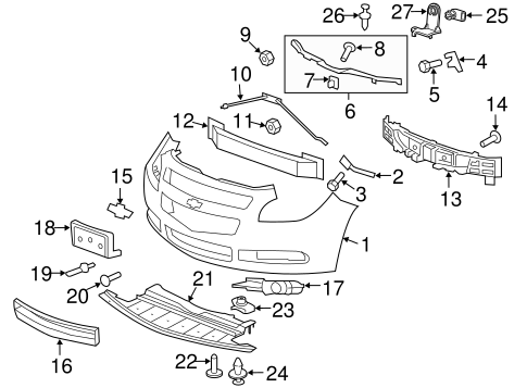

Number 21 is what I got.
Someone had a blow out in front of me which caused my engine splash shield to partially come off. I found the part number on GMPARTS but can’t seem to find a how to video to install it. Does anyone know a good how to?? Or maybe I got the wrong part number? The part number is 15826166 that I bought.. any insight is grateful, thanks!

Put it up on ramps and pull the retainer clips off and drop the old lower engine cover .Find the right size at any auto store or online and reinstall. They are dirt cheap and come in different styles.
