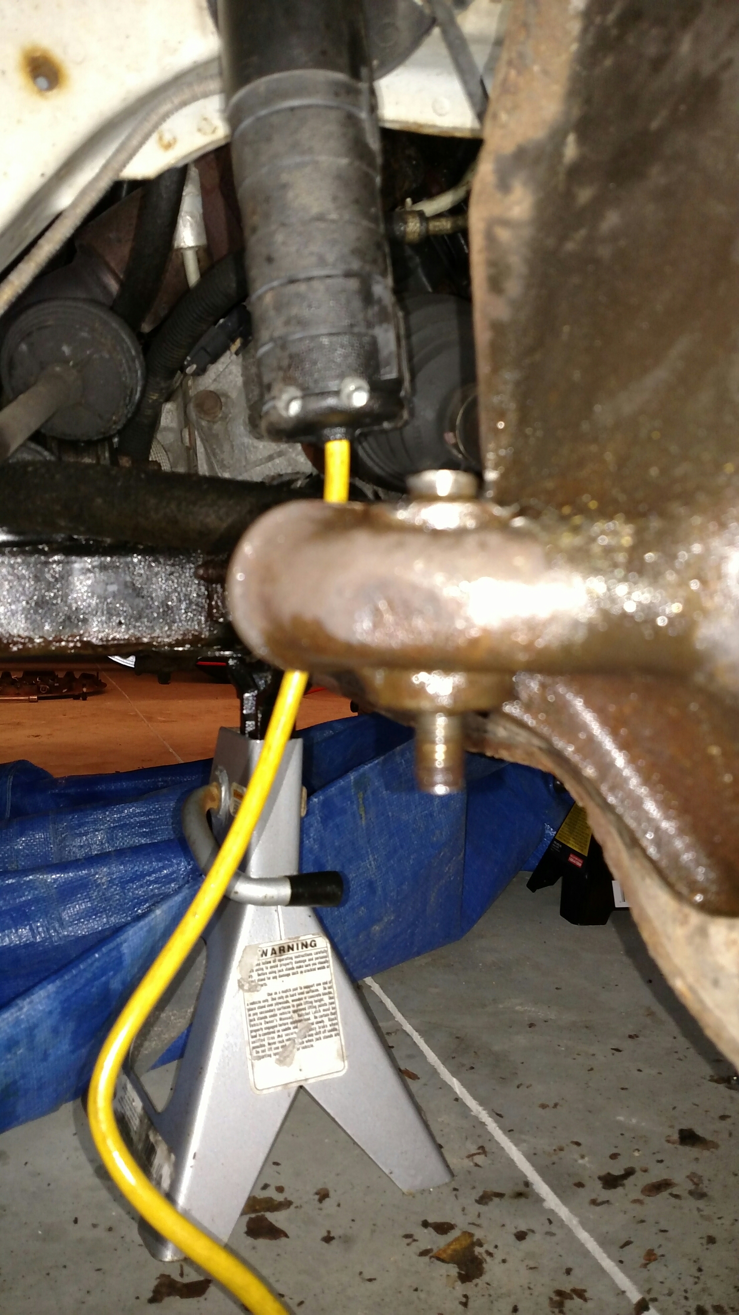

For the short of the story, Made a mistake. Cut the tie rod off, at the stud. Was not coming out. Thought I'd be able to get puller of some sort on it.
Any ideas how to get the stud out?
I tried putting a gear puller on it, upside down, as I later realized its a tapered shaft? Problem is with the taper of the arm, having a problem keeping puller arms on.
Attached Thumbnails Newbie with power steering leak-img_20160104_192248264.jpg

I can't make anything out from the picture.
if this is the outer tie rod end attached to the knuckle. If the nut is off, hit the knuckle hard with a big hammer. hit the knuckle where it surrounds the tie rod end. you want to hit the side face of the knuckle not the top or bottom. goggle eric the car guy. he usually has good videos and knows what he is doing compared the all the backyarders on you tube; who should not be posting car repair advice.
before you loosen the outer tie rod from the knuckle, crack the lock nut on the inner tie rod end. you will not be able to do it easily once the outer tie rod is free from the knuckle.
this is not a nice job to do in your driveway on jackstands. Everyone should have to do this; afterwards they would appreciate the job mechanics do.
