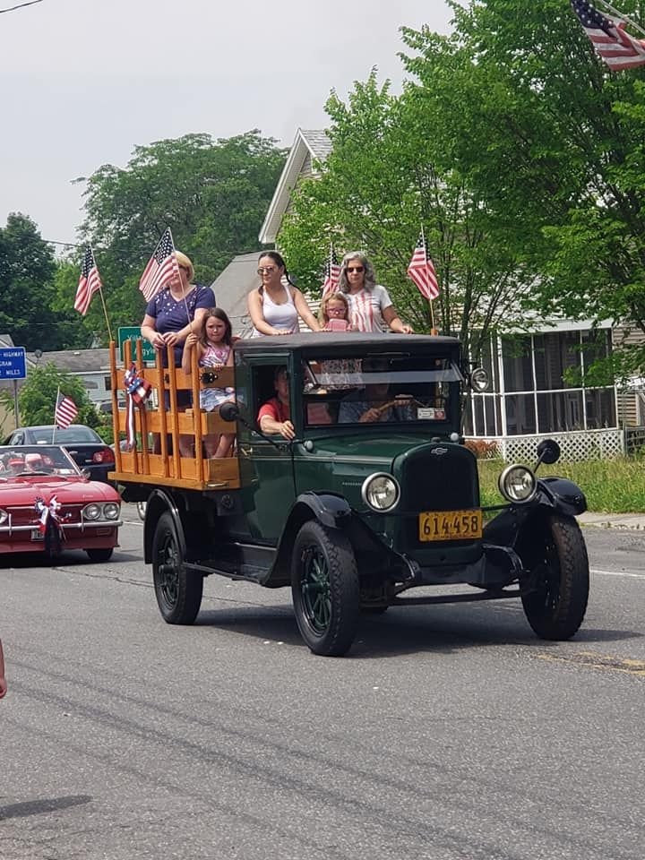

Truck works great - just a minor clutch issue/noise. At the time of this picture - there were no issues w/the clutch.

Great pix !
