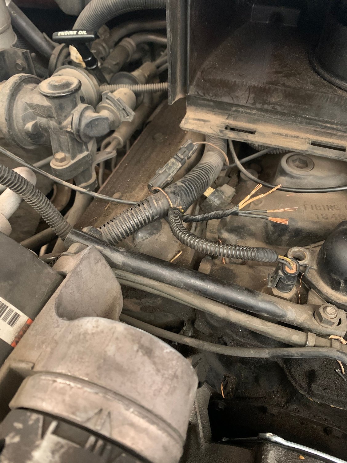

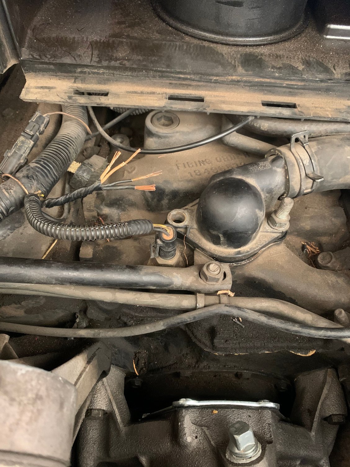

I was trying to change my thermostat and I did but there were wires connected to the bolt and I was taking the bolt off the wires ripped off. I’m trying to ask what can I do to fix this problem.its a Chevy caprice classic 1991.

Get a crimping tool and the correct sized terminations and reconnect them like they were, they are all grounds.
