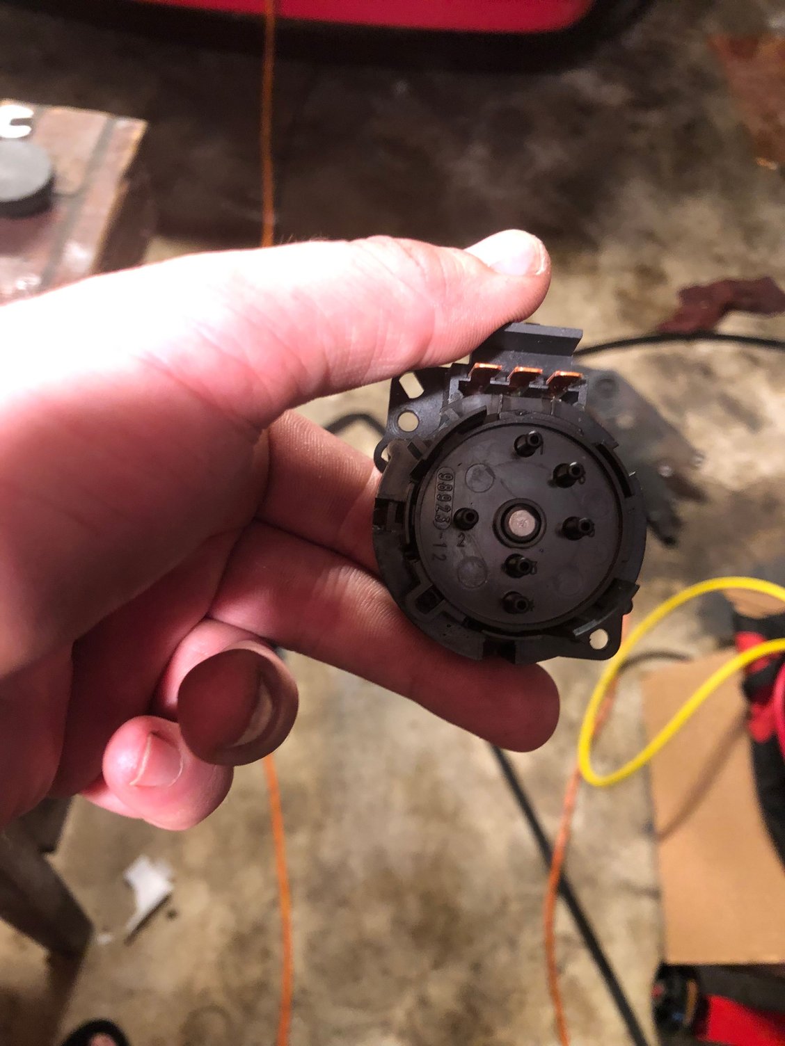

I could use some help with the name of these parts. I can’t find them anywhere and they don’t come up any related item search. The first one is for the ac control in the dash. It is the switch attached inside to the **** that changes from ac on/off/ac max and which vents it blows out of. Currently it is blowing out of feet and defroster on all setting. Maybe fixing the leak with turn of the sensor allowing the clutch to engage and this controller to work but if not I might need to replace the switch. I found the whole ac dash control component for $200 and all the other components individually except for this one. Any leads would be appreciated.

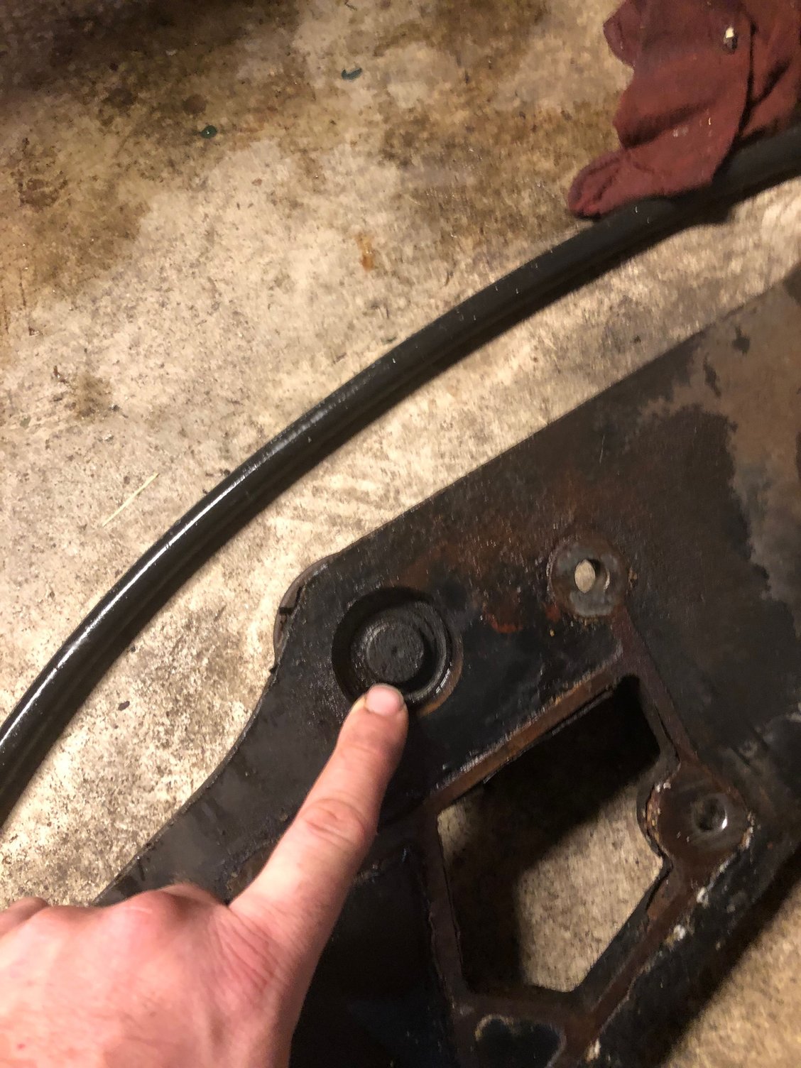

The second one the shaft/bearing on the engine fan pulley bracket. Again I found the whole setup for $100 but if I can get the shaft/bearing for $20 and press it in I would rather do that. Thanks again for help!
How long was the A/C system open to atmo? If a long time, you'll almost certainly have H2O in the polyalkylene glycol oil, as ii is a fully synthetic hygroscopic oil. I'd suggest flushing the system with a kit and installing a new accumulator and orifice tube.. You may have to buy a new condenser as the new, cheaply made R-134A condensers have small passages these day, that are much smaller then in times long gone by. So if any foreign material that is now in the open system, might well end up clogging up the condenser, leading to a system failure.
You can, however, flush out the rest of the system, then install the new accumulator and the orifice tube. using the new PAG 150 oil. Yes, if there is a leak, then of course that needs to be found and repaired. Having atmo in the system, without vacuuming it out is one reason why it wouldn't cool properly, as well as not being able to boil out the water that was in the system as well, and the O2/N2 atmospheric gases tends to lead to much higher operating pressures in the A/C system too. Your A/C system calls for 8 ounces of PAG 150 oil and 32 ounces of R-134A., but that is for a new or completely flushed out A/C system. This is a table that roughly gives you the amount of PAG 150 oil you will need to add for an 8 oz, system, depending on what is replaced/flushed, give or take, and many factors like how large or small the A/C system is:

A little extra PAG 150 won't really be an issue, particularly if you install a new accumulator, but getting the R-134A up to normal amounts and pressures is very important. I would wait until you get the A/C system back to normal before you buy the dash control unit. No use spending hard-earned money on something you may not need at all.
