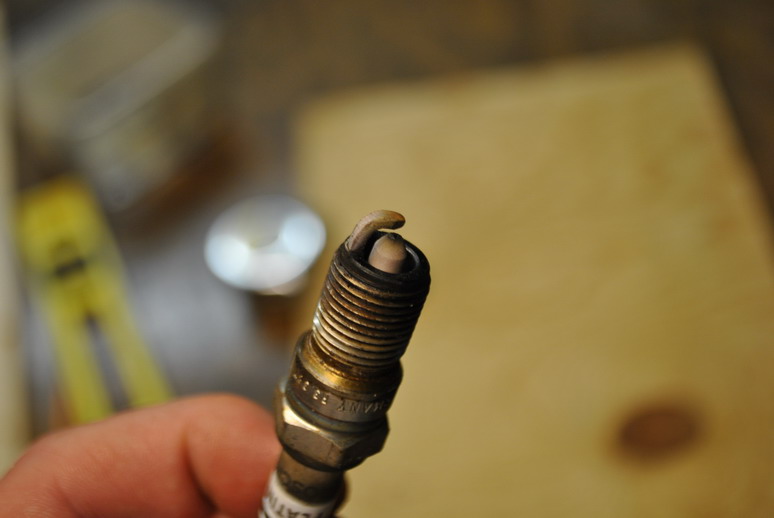

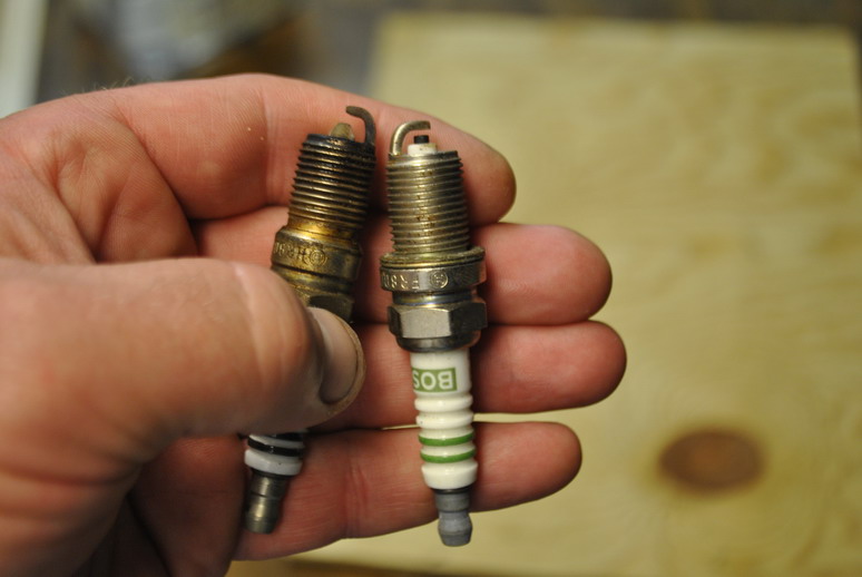

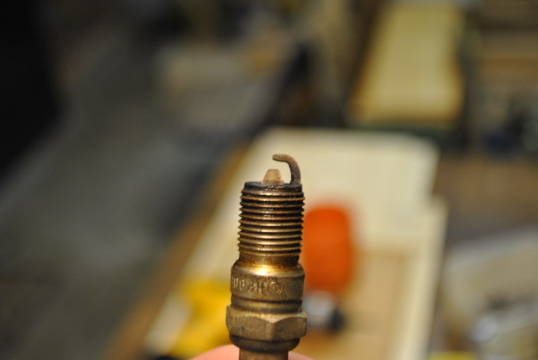

I removed the number 6 spark plug per the code. Does it look bad? I checked the gap to be 0.065, pretty close to specs. The wires looked fine to me, I mean I'm obviously no pro but they weren't cracked or worn looking. I looked at the wire going to plug 6 and it felt like it had a good seal and came off fairly easily with a gentle twist. I think the plugs and wires are 4 years old. I probably put 30k miles in 4 years.
I attached pics of the plugs. I found a plug in with some misc car parts I have (see pic). Is there any reason why this plug wouldn't work in the Blazer? Or should I try and clean the one I took out, regap, and put back in?

Wires can go bad internally and look fine on the outside. Swap #6 wire a different cylinder see if the code follows the wire. You can not just use any old plug it must be correct for the application. The plugs you had in it are junk. I am surprised they worked at all. Bosch plugs should only be in European cars but for some reason chain stores push them. They must make the most profit off them. Regapping and cleaning could work but it is the wrong thing. When plugs are worn out they should not be re gapped they should be replaced. Move #6 plug to a different cylinder (other then where you move wire) See if it follows the plug. REPLACE which ever one it follows.
