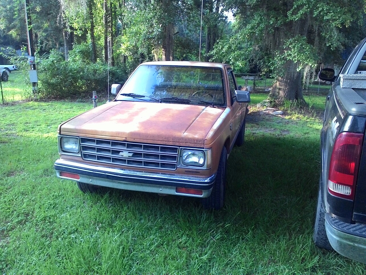

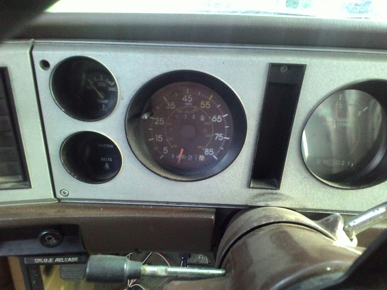

I know this is a diff prob I got intirally but my choke light stays on in my 1984 s10 durango pickup but when I jus barrally tap the gas it idalls down so I know my choke is working good but I also know it's missing some parts off the carburetor can't complain bout it tho it been a Damn good lil truck pulled some heavy loads with it have put a lil money into her to jus some things I got a deal on
joshuasoileau
