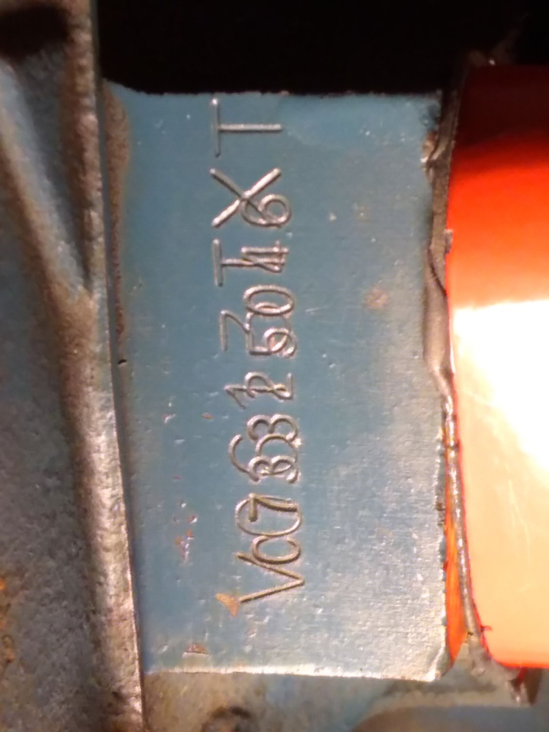

I purchased an 89 s10 to put on the drag strip..
it runs fine, we just don't have an idea what kind of block is in it..
we found 2 numbers, stamped on top of each other.
VO613TXT
And
C73325046
Maybe someone can help me?
we think it might be a 265 block from 1955?
Thanks a lot

I did an online search and found this.
V0613TXT
V for Flint
0613 for June 13
TXT for 1975 350
frwd cab LLS9 4 bbl
C20 to 3500

I believe that makes it a truck engine which would have a forged crank and 8" harmonic balancer. If it has a 6" harmonic balancer, then it is a cast crank.
Any idea what the restamp was for? Maybe a rebuilt engine?
