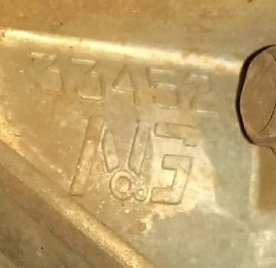

I have a 1999 S-10 with a 2.2L engine and I am going to change the engine in it, I also want to change the front and rear seals in the transmission but I am not sure which of the two manual trannys I have. The only markings I can find are on the tailshaft of the tranny read NG 33452. Can anyone tell me which one by this picture?

I have an '01 S-10 2.2L, with the exact same stamp on the trans. Were you ever able to confirm which transmission this is? I am having the same problem.

NVG not NG.
https://en.wikipedia.org/wiki/New_Ve...0_transmission

https://www.700r4transmissionhq.com/...ation-m50-md5/
