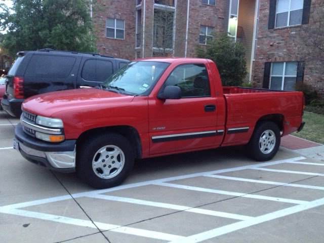

oh and here are some pics of my lucky win!
