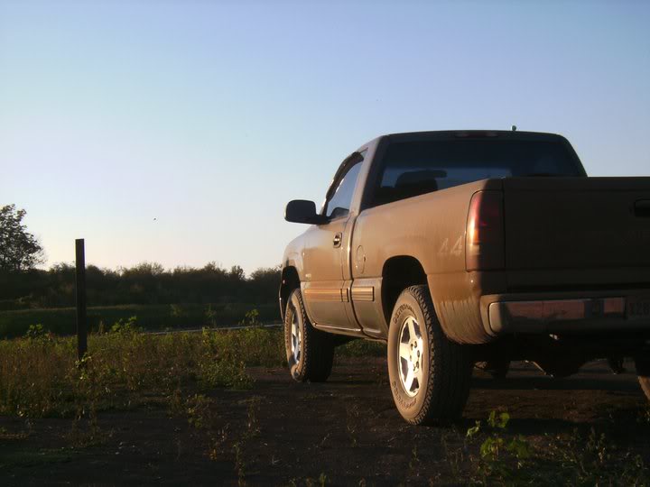

Pictured is the truck, she's been great but has a couple issues.
1st. - When cold, hard to start, if I turn the key on 4 times, then crank it, starts right up. If not requires some spinning. I am thinking fuel pump, or a cracked hose bleeding pressure in tank.
2nd. - ABS and Brake Light come on more often than not. No clue why, only code she is throwing is asking for a good tune up.
2000 Short bed Chevy Silverado
4.3
Automatic
4X4
