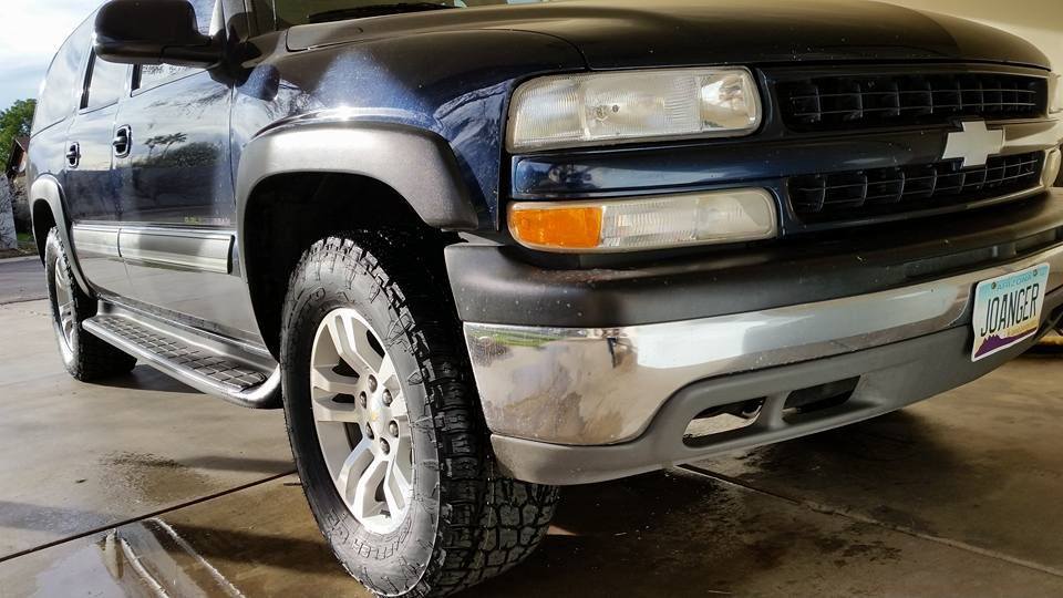

Here is my 04 subby LT 2wd..... I just fit 305/60/18s under with no issues at all. No rubbing, no trimming. You will have to crank up the factory bars & get a wheels alignment.
Old Feb 11, 2017 | 9:49 AM
Keith Hesney's Avatar
305/70/16
285 70 17
305 60 18..... these are all the same size (give or take). All of them are approx 32s x 11.5/12"
Old Feb 11, 2017 | 9:52 AM
The absolute smallest rim you can put on there are 16s. Most 1500/2500 come factory with 16/17/18 year specific. 2000-2006 came with 16s
