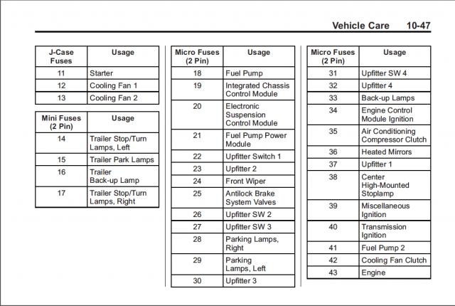

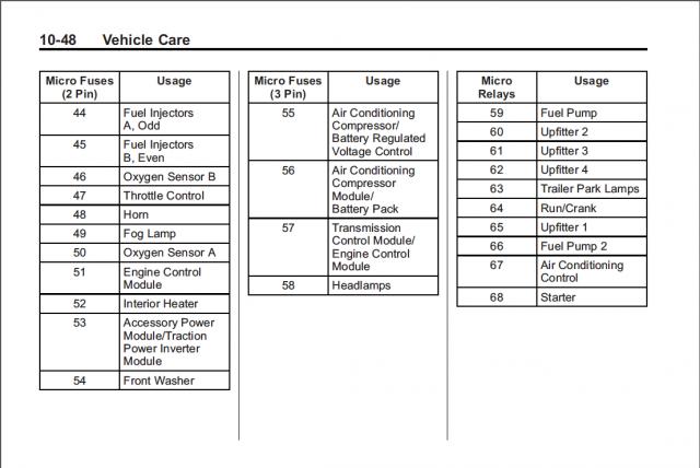

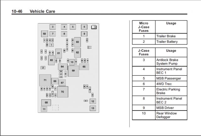

Does anyone know where the heck this fuse is in the truck if it has one or a possible way to permanently disable the DRL lights, but not the automatic low beams? attached are the images of the 2014 silverado under hood fuse box diagram and no DRL fuse or relay??

Just looked up the fuse for my 2014 GMC Sierra. Says DRL is fuse 31 in the "Engine compartment fuse block" located in the engine compartment drivers side.

There is no fuse on the 14 or 15 it's bcm controlled
