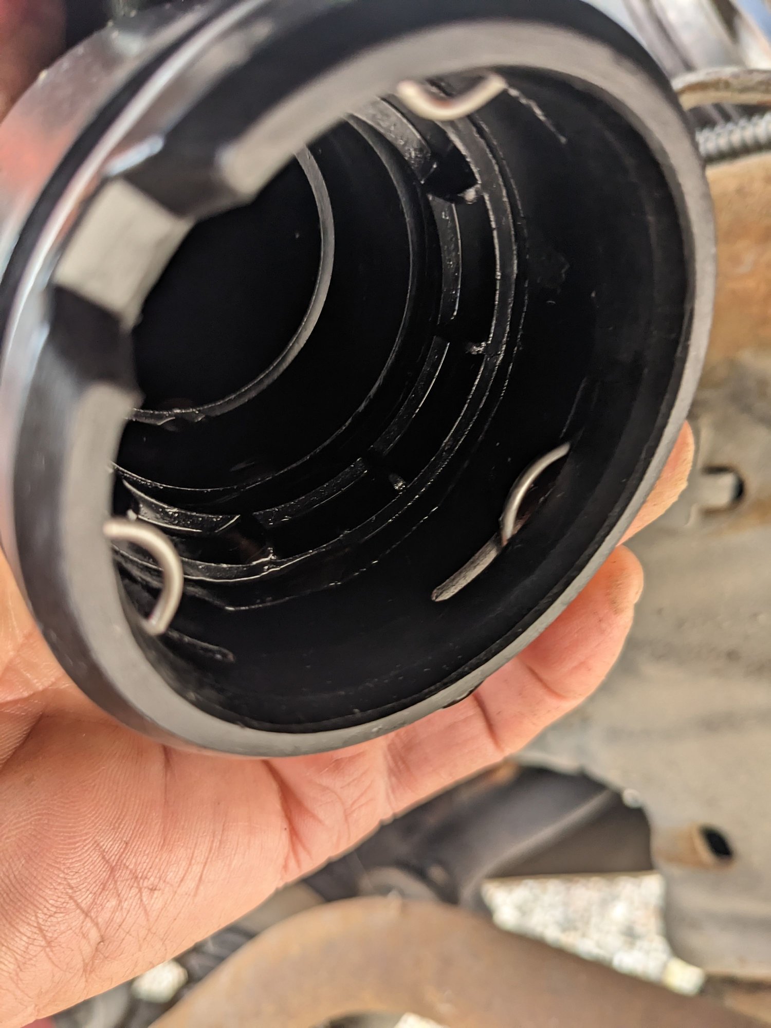

lower radiator hose end
Lower radiator hose inside showing retainer clips
Lower radiator hose attachment

I've attached photos to this thread. I'm not forum savvy but the photos are below.
Thank you for any insight you can provide.
I can push the radiator hose onto the radiator but it will not lock into place.

The clips are for a radiator hose. I have attached photos for better information on my problem. Thank you for any help you may provide.
Old May 24, 2023 | 7:42 PM
that is the charge air hose for the intercooler...

To the OP - did you get it connected? Leave the clip in place on the hose and use lubricant to help the hose seal seat correctly. Once it’s far enough on that the locating tab prevents rotation of the hose, rock it top to bottom (or side to side depending where the tab is) to push it the rest of the way on. The clip will “snap” once it’s in place, but be sure to inspect that all 3 parts of the clip are seated.
The 8.1 engines don’t have a CAC. They utilized the same style of quick connect for the lower radiator fitting (no idea why).
Originally Posted by dpieroni3
I usually lube the seals in the hose so it assembles easier
Same here. A light coating of engine oil or Vaseline/grease on the radiator side of the fitting helps it seat.
