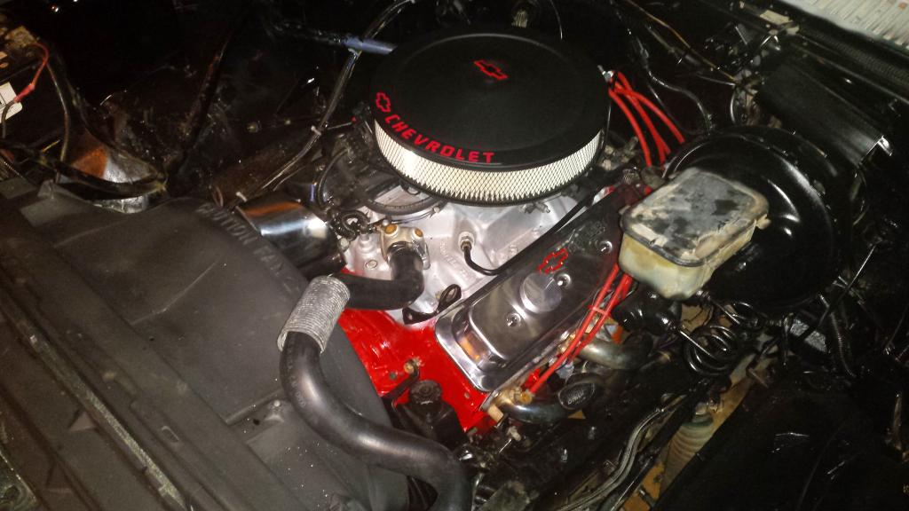

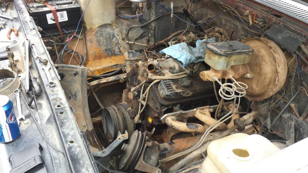

Is this a temp sensor problem or is this a pressure regulator problem? Fuel pressure is confirmed at 55 psi. so I know thats not the problem. Here are a couple of pics to let you know what I am working with. I know the first pic looks bad but it was only mud and a bit of oil on the engine when it was pulled.
this is what I started with.
this is what I ended with along with the persistent problem.
